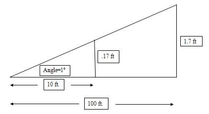

It's the camera shake. The longer the focal length, the more movement affects the image.
IMAGE: http://i182.photobucket.com/albums/x157/Bendel0240/Triangle.jpg
Sorry for the crude drawing. Basically, 1 degree of movement over 10 ft caused .17 ft of movement at the subject's position. 10 times the distance causes 10 times the deflection, which means the subject moves 1.7ft.
To solve it:
1.Move closer-not really an option in sports.
2.Use a faster shutter speed-iso 800 shouldn't give you noise issues but it will allow you to bump up the shutter speed
3.Reduce camera movement-tripod or mono pod, since it is for sports, a mono pod will give the most flexibility for movement.
Edit: I hadn't refreshed the page recently to find out you had been using a mono pod. I guess that eliminates option 3.

Thanks for the reply, and sorry for the delay in responding. I was at the ball fields all day yesterday. Great drawing by the way, makes sense.
