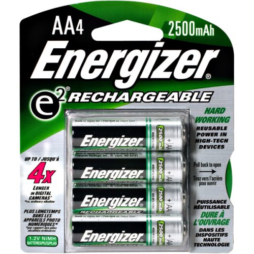

I run these without any problems. Had the camera for 3 weeks and still haven't had to recharge them. Plus you can get the 15 minute charger which works great for me since I hate waiting.
IMAGE: http://ecx.images-amazon.com/images/I/6120QRFVYRL._SS500_.jpg

I don't believe the one hour and fifteen minute chargers fully recharge the batteries. I used them without much luck. With Eneloops and other hybrid batteries, and a slow charger, I get great results.

Same here: slow chargers (3 hr for 2500mah) are working nice with mine.
