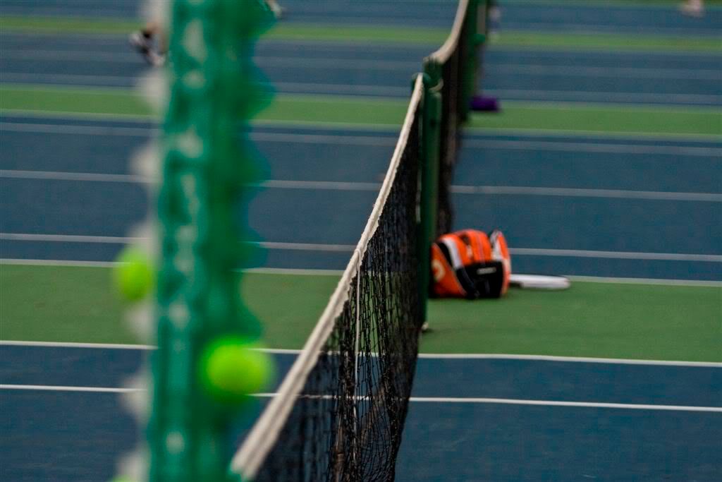

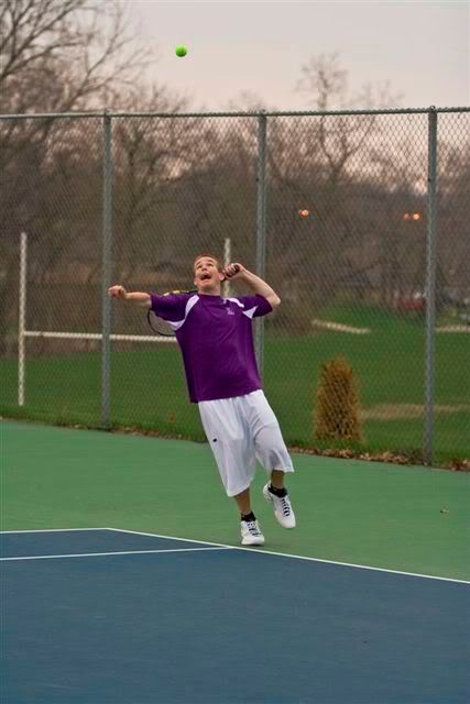

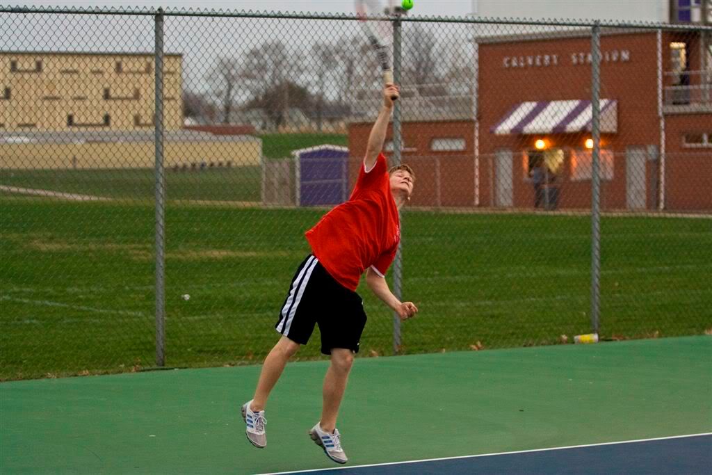

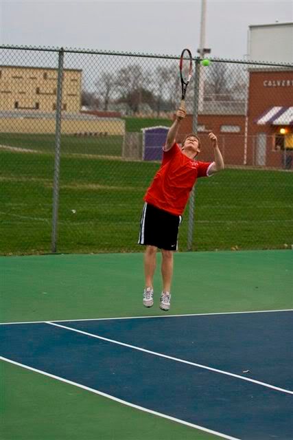

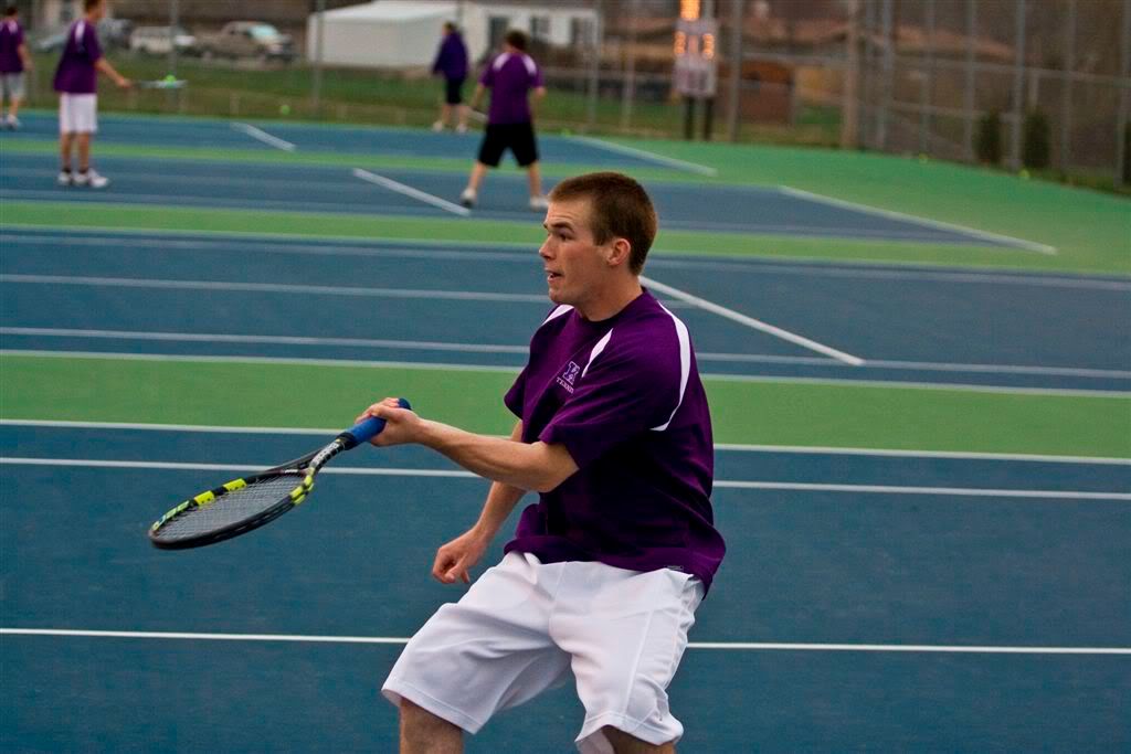

Got my rental Canon 70-200mm f/2.8 today, went to the local hs to shoot some tennis just to get used to the lens. I think I should have used a faster shutter speed on all of these, but some of them turned ok. I think they are all a bit soft. Tips, critique, anything to help me improve? Thanks!

you might want to try shooting different types of shots, not just the serves.
mustve been quite dark to be at iso800. and yes i wouldve tried to get a higher shutter speed.

Yeah it was very overcast, had to get up to ISO 800 and f/2.8 just to keep the exposure right. I tried getting returns, but none of them really worked out. Will definitely try more next time.

i like #5, but I'm no expert on specifics

IMHO, go tighter, and it's a common problem with lower level tennis, multiple matches go on at the same time,
i suggest trying to find the angle to isloate only 1 court, shot further back down or go in tight. I feel that it makes the image cleaner.

And I don't even know what shot number 5 is all about. It almost looks like a frame where you accidentally hit the shutter.
Your shots are OK. The shots other than number 5 show good timing, but are a little soft IMO. Might be due to low shutter speed and might be due to bad AF. Since you didn't post your EXIF, I'm not sure where your shutter speeds were. Here's what I was able to pull off one of your images: Lens Focal Length (mm): 70; ISO: 800; Aperture: 2.8; Shutter: 1/400. Bump your ISO to 1600 which would get your shutter speed up to 1/800s. Yeah, you'll get a little more noise, but this will increase the sharpness of your images. Deal with the noise in post processing.
Also, unless you're shooting a forehand return from across the net, or a few other isolated situations, I'd suggest shooting vertical and not horizontal.
