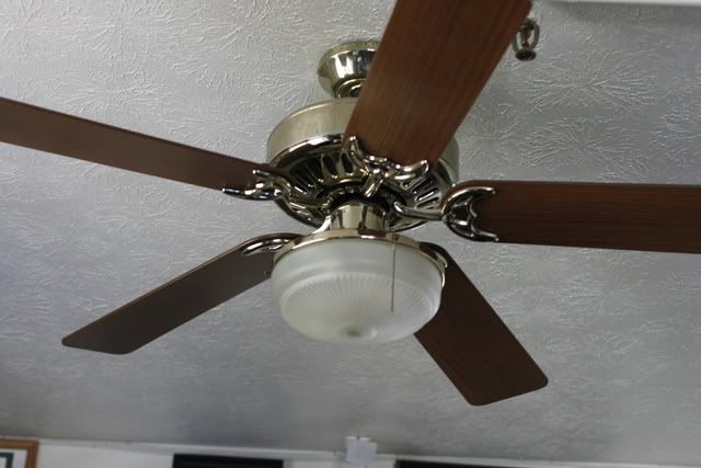

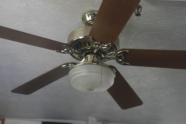

I've recently got the Sigma 24-70mm and I noticed a problem with the lens. To me it seems there's a cloud like smoke in the lens. I've compared it with my 50mm and it looks more sharper than the sigma. Do you guys think this is normal or if it's a problem I should send it to sigma. Also, can you give me a more specific way of tell Sigma the problem.
Thanks
Here's some pictures of it. The first two pictures were at 50mm, 1/15,f/4
Canon 50mm
IMAGE: http://img.photobucket.com/albums/v283/AXFREAK/misc/_MG_0292.jpg
Sigma 24-70mm
IMAGE: http://img.photobucket.com/albums/v283/AXFREAK/misc/_MG_0296.jpg

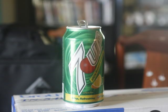

Next set Canon at 50, Simga at 52 , 1/20, f/2.8
Canon 50mm
IMAGE: http://img.photobucket.com/albums/v283/AXFREAK/misc/_MG_0203.jpg
Sigma 24-70
IMAGE: http://img.photobucket.com/albums/v283/AXFREAK/misc/_MG_0204.jpg

Is this with or without the hood. It is prone to light spill and flare without the hood pretty easily.
Everyday, a programmer finds a way of creating an idiotproof program. Everyday, the universe spits out another idiot.....So far, the universe if winning

Hmm thats interesting, have you tried some tests outside with more sun to see how it copes. I can see the lack of saturation on the can pic.
Ive never really had this problem with mine so only other suggestion would be a not so great copy? Suppose best to wait for others to chime in.

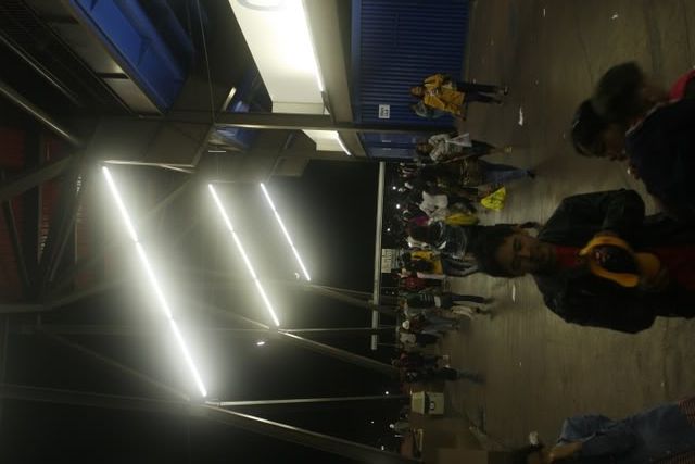

Here's two more pictures I took last night. One was with my kit lens and the other with the Sigma 24-70. Both were taken at 24mm, 1/30, f/4
Canon 18-55
IMAGE: http://img.photobucket.com/albums/v283/AXFREAK/misc/_MG_0647.jpg
Sigma 24-70
IMAGE: http://img.photobucket.com/albums/v283/AXFREAK/misc/_MG_0646.jpg

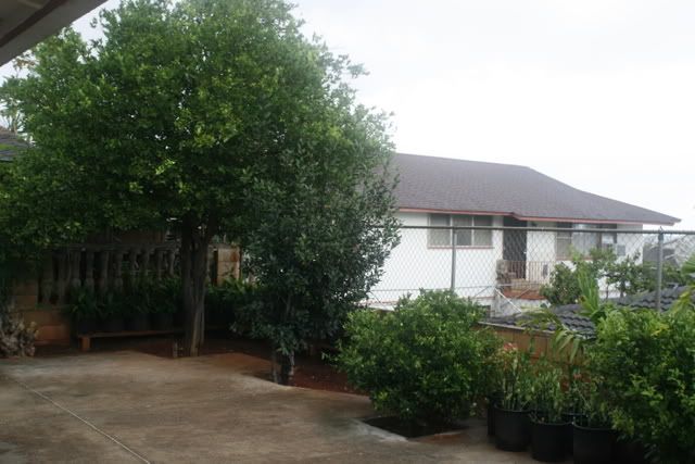

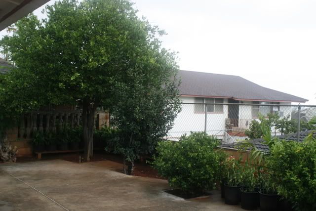

Here's some shots I took today. All shots were taken at 24mm, iso 100, 1/20, f/8. All were taken with tripod.
Sigma 24-70mm With filter
IMAGE: http://img.photobucket.com/albums/v283/AXFREAK/misc/_MG_0657.jpg
Sigma 24-70 Without filter
IMAGE: http://img.photobucket.com/albums/v283/AXFREAK/misc/_MG_0659.jpg

Do you guys think it's the lens? Is it a good idea to send it to sigma?

Wow that doesn't look good. Give it a good, through cleaning on both sides, and if the problem is still there, send it back.
