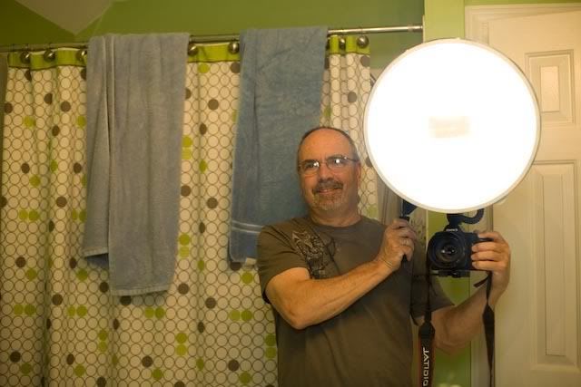

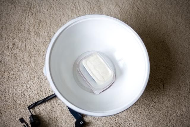

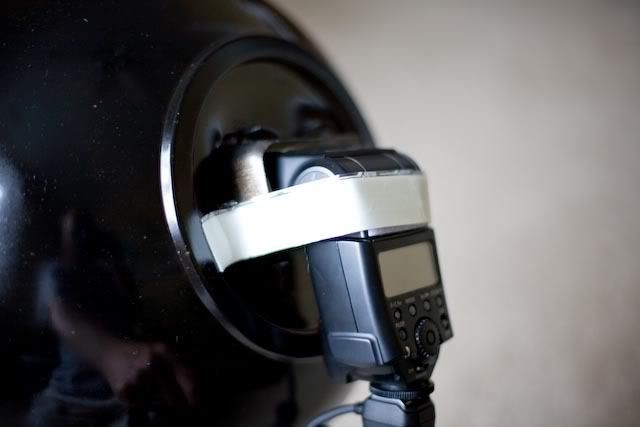

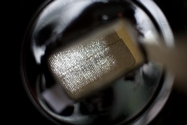

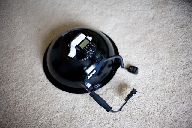

May 23, 2008 13:59 |  #13
While not the most subtle diffuser, I made this home made "beauty dish" for my 5D and 580 EX. It produces a very soft, flattering light.
IMAGE: http://i182.photobucket.com/albums/x148/jcolman_photo/IMG_2149.jpg
IMAGE: http://i182.photobucket.com/albums/x148/jcolman_photo/IMG_2175.jpg
IMAGE: http://i182.photobucket.com/albums/x148/jcolman_photo/IMG_2176.jpg
IMAGE: http://i182.photobucket.com/albums/x148/jcolman_photo/IMG_2174.jpg
looking inside at the reflector
IMAGE: http://i182.photobucket.com/albums/x148/jcolman_photo/IMG_2177.jpg
wide shot with the "beauty dish"
IMAGE: http://i182.photobucket.com/albums/x148/jcolman_photo/IMG_2158.jpg
