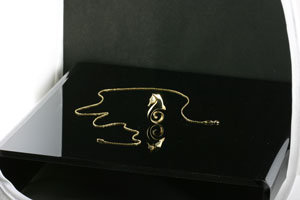

What you are seeing is a reflection of a white background on a black surface. You need to change the background as well, to black. Leave everything not seen in the frame as white. The "float" will still be there, just in black not white.
Notice the reflection on part of the black acrylic here....
IMAGE: http://www.tabletopstudio.com/images/jewelryphotography/seahorse_setup200h.jpg
THis is what you are getting, when you change the background yo will get what is on the right side.( no reflection)
Final image...
IMAGE: http://www.tabletopstudio.com/images/jewelryphotography/goldseahorse_200.jpg
The black background will also help with the burnt out spots on top of the tomatoes. A light tent will help tremendously. A cheep sheet and a support of some kind is all you need. Dont buy the $100 tents Unless you plan on doing a lot of stuff. Check this link on how to build one... http://www.pbase.com/w​lhuber/light_box_light​_tent (external link) Also dont trust your light meter in times like this. Too much black or white will throw it off. Use it to get a base then open or close down by hand till you get whar you need.

hey mark, thanks, interesting......so lets say if i'd take black acrylic platform and on 2 sides cornering each other put black backgrounds, then i would be halfway there.
I want to achieve exactly as what you pictured here but im still lost, where do i put my lights then? do i have to use a snoot to beam the light in from far away so theres no softbox which will reflect again maybe?

Lights are on the sides and top. Black acrylic on bottom, flat black background. Got to go for a few hours.... I can help more tonight. Reed the DIY light box thread here........ https://photography-on-the.net/forum/showthre​ad.php?t=281524
