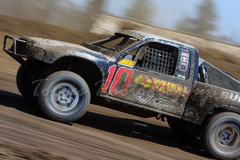

I you are trying to pan you need a much slower shutter speed. I shoot at a max of 1/250 for a race truck moving at over 100 mph, and get as low as 1/40 or 1/60 sec for effective panning. 1/1600 sec will freeze everything especially at only 20 mph.
And shooting at iso 100, Tv mode, in sunlight, you will end up with an aperture value around f/10-f/14 or so. This will help with your depth of focus.
Also panning that slow is difficult even for someone who pans a lot and is good at it.
Example: Tv mode, iso 100, 1/100sec, f/11. 40D, 70-200mm f/2.8, shot at 125mm.

Yes I followed the truck through a 180 degree turn with a slow shutter. I picked a spot on the truck and kept my center focus point on that spot.
I only increase my shutter speed when the trucks are coming at me, to 1/500 sec, to keep a little blur in the back ground, but mostly to keep the tires blurry to show speed.
