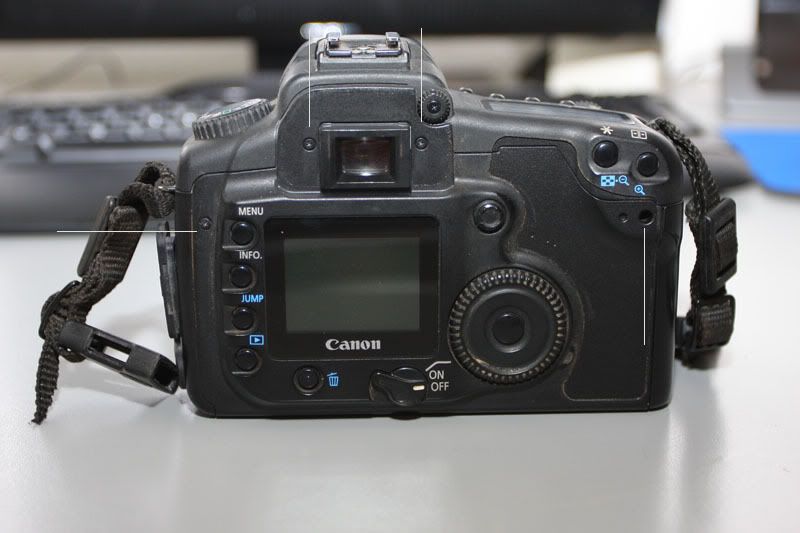

As requested above I took my 20D apart again to clean behind the LCD cover and took pictures this time.
- First remove the battery & peel off the rubber grip on the back of the camera, it should come right off. There is a silver screw at the top right side under the rubber, remove it.
- Then remove your eye cup and remove 2 screws behind the cup. These are 2 of the 3 longer black screws.
- Remove the 3rd long black screw from the top left side next to the menu button.
IMAGE: http://i88.photobucket.com/albums/k173/ryant35/IMG_3951.jpg

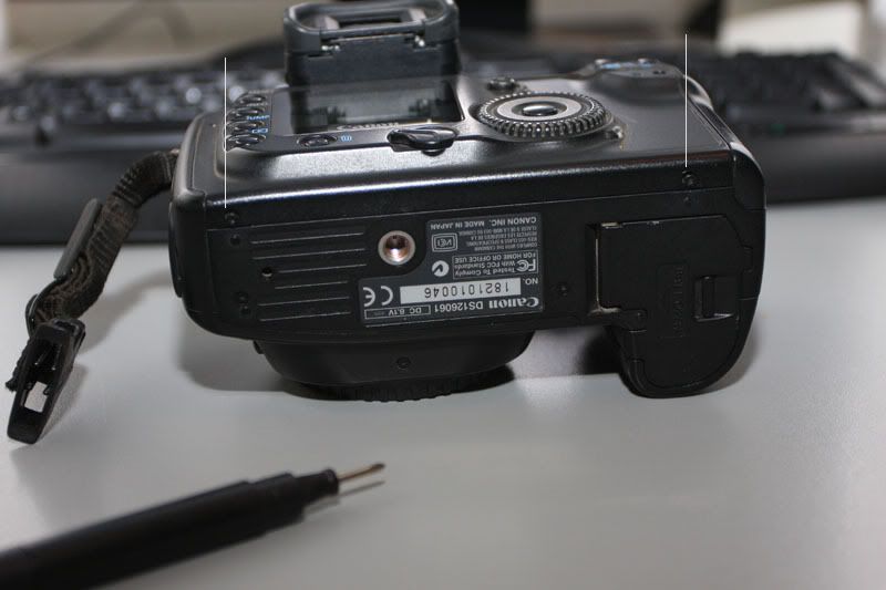

On the bottom of the camera there are 2 short black screws on the back cover, remove these. Now the back should be loose.
IMAGE: http://i88.photobucket.com/albums/k173/ryant35/IMG_3950.jpg
