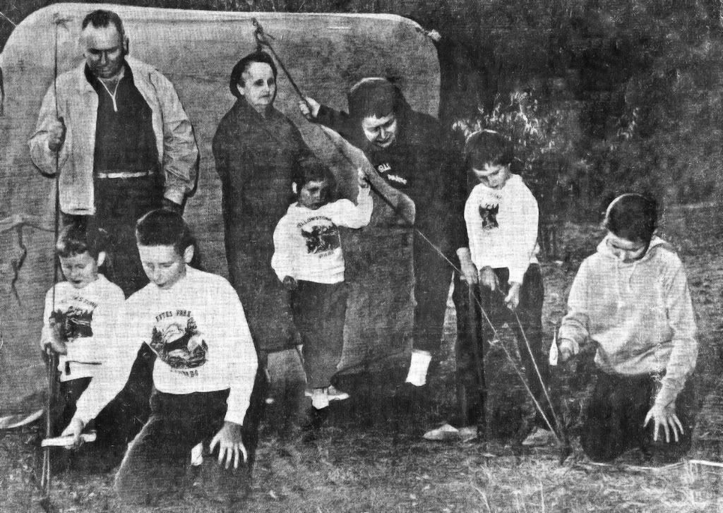

My mom asked me to work some “Photoshop voodoo” into a picture for her. I’m still searching for the “voodoo” button in my copy of elements, but until I find it, I need help! I did some healing, cloning, a black and white convert, and noise reduction, but this picture hasn’t gotten a whole lot of love in 45 years, and this is my fist time trying any restoration work, so any suggestions or edits would be much appreciated!
Here is the Original:
IMAGE: http://i266.photobucket.com/albums/ii262/bigbitt8706/scan0004.jpg
and here is what i have thus far:
IMAGE: http://i266.photobucket.com/albums/ii262/bigbitt8706/scan0004-edited1_edited-2.jpg

As you have figured out, the newspaper print is with a 65 line screen so a whole lot of info/quality is missing.
Kodak has a series of software plugins available that can be very helpful in working over old photos. Try googling Kodak Pro.....

I would take the glass off a couple of picture frames (non glare preferably) and place the newspaper picture sandwiched between them. This will help flattening the creases, and then scan it or take a photo of it with proper lighting to avoid any flares on the glass. Probably then you may have a better picture to restore. You will have to deal with the issue Jon mentioned.

Bigbitt - If you can post a better original, flattened under glass, etc. per Mike_D, you might be able to use a couple of different techniques. Here is an example where a regular pattern (a screen pattern) was removed with a filtering technique called Fast Fourier Transform filtering, and then that image is manipulated to final. I used Neat Image to remove the noise after FFT treatment, but I am sure there are many other ways. If you use basic blurring techniques, or noise removal techniques, on the entire image to remove the regular screen pattern, you will essentially be losing all of the detail at the screen resolution (sort of what Jon is referring to). With FFT, you can target the frequency of the regular pattern, remove that component of the image, and retain more detail for sharpening, etc.
If the screen frequency is 65 LPI, you want to scan the original at least twice that frequency to avoid aliasing the screen data.
Post a better original and I'll give it a shot. Here are a couple of links to my smugmug page with some FFT examples:
