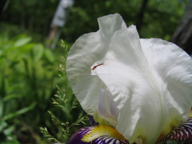

My S1 IS is starting to show horizontal lines through the images, especially when cropped. At first it was one line, but now it is multiple. Is it the camera, or the memory card?

Ok, so here is a cropped image showing at least one horizontal line, and possibly one vertical.
IMAGE: http://i154.photobucket.com/albums/s254/drevilsmom/stiltbug1.jpg
Here is the original:
IMAGE: http://i154.photobucket.com/albums/s254/drevilsmom/IMG_6472.jpg
I didn't notice it until this spring, and it seems like it is getting worse. My camera has about 77XX actuations, and I've had it since December of 2004. It's probably more than doubled its actuations since the beginning of the spring, which is when I really started getting into insects.

That would be the camera. I really had to dig to see it though!

So, my question is.... What is causing it? Sensor problems, maybe?

Yes, it'd be a sensor problem, but I doubt it's covered by the Service Notice; nothing I've seen on that discusses single lines, it's more an area type thing.
