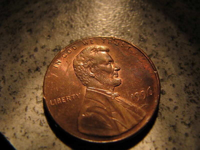

Jun 28, 2008 21:10 as a reply to  @ BBoi's post |  #11
Hello, I am pretty new to photography, and even newer to this forum. I just purchased my S5is about a month ago, and am loving it, I have taken about 1500 shots so far with it. I am still a little leery about posting my shots on the forum, I am still learning and when I think I have something good enough to share I will start sharing. Anyway like I said I am pretty much a photo newb, and I don't know if this will help or not, but I think the only real good way to get good looking macros with this camera is to use a manual setting, I pretty much always use M so I can quickly adjust everything I need to . I just shot a pic of a penny, I don't have a good indoor light source, like you have, if I did this would have looked a lot better, and a had a lot less shadows, but I think it came out looking very clear. I do plan to purchase a ring light for doing these kind of shots that will help a lot, but it seems like you have a good enough light source.
IMAGE: http://i26.photobucket.com/albums/c135/mullhawk/IMG_1546-1.jpg
I took this with a 1/250 exposure time F2.7 ISO 200 (edit: also I used the supermacro setting for the shot)
Sorry if this is no help to you, I realize you said you don't want to switch to manual mode, but I think it is the best way for you to get the shots you want.
