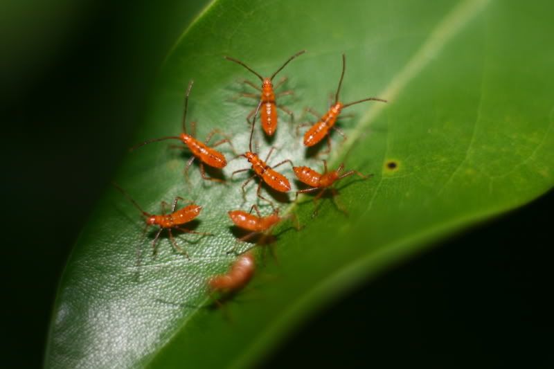

I am new to MACRO so hope this is not a dumb question. Have been using Hoya diopters and was not happy with the details of my photos. I can not afford a dedicated Macro lens so I bought a set of extension tubes. They are 13mm, 12mm and 31mm each. I know that it will take some practice to get familiar with them. My question is; I have the 50mm 1.8 and and the 50-250mm IS lens. Which lens/tube combos would you folks recommend using to get the best quality pics? Any input would be appreciated.
This was my first attempt using the 50mm 1.8. Only issue was I had to get less than an inch away from them. CC is always welcome but, I do know that there is much lacking in this pic.
IMAGE: http://i14.photobucket.com/albums/a345/silverpony2000/IMG_4998.jpg
Thanks

You'll find out which tubes to use as you go for the different effects and see how hard it is to remain focused when you start stacking tubes.
In the past when I used tubes I just tried this and that to see which one, or combination, worked best or what I was shooting. The best way I focused back then was to set the lens on infinity and move the camera in and out until focus was achieved.
This was back in the "old days" using a Nikon F and film but the same still applies.
