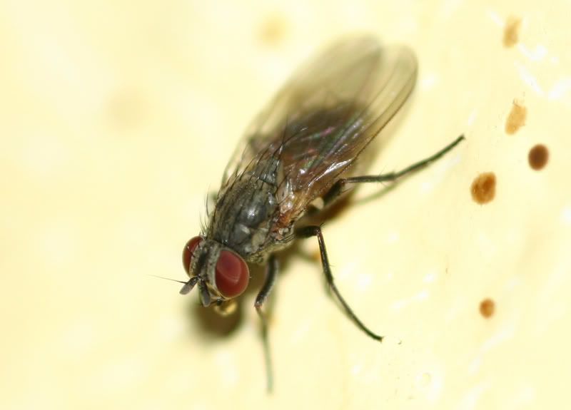

yes i have the Sigma MACRO 105mm f/2.8 EX DG, im happy with the resalts its a great lens, i took this picture of a fly, cropped
IMAGE: http://i3.photobucket.com/albums/y99/picardo/macro/croppedfly.jpg
however i have been toying with the idea of getting in closer to insects, read about tubes and kenko tubes heard theres no real diffrence between the two.

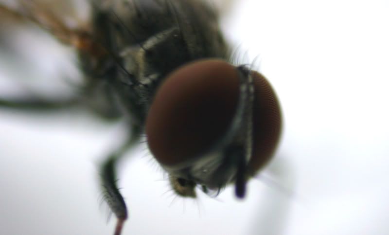

however i did have a play with my 18-55 lens today reversed on my sigma 105mm and like the closer resalts from it even through quailty was not the best.
IMAGE: http://i3.photobucket.com/albums/y99/picardo/macro/croppedflyreverselense2.jpg
being quite close it was hard to get all the subject in focus the av aperture
was set to lowest. overall i liked the closer results it gave. and im not even sure if the the 18-55 canon lens was the ideal lens to use as i just heard about the 50mm, hopefylly someone can put m straightt on that.

first shot not bad second shot you have missed the focus abit!

yeah 2nd shot was with my 18-55 lens, without proper fitment just testing it.
will the 18-55mm lens be ok as a reverse lens? as heard people just talking about the 50mm?

I'd get a set of Kenko ext tubes - easiest to use and no IQ loss. With the cheapo ebay ext tubes you lose control of the aperture which is a pain. A set of Kenkos will take you to 2:1 max with your sigma.
