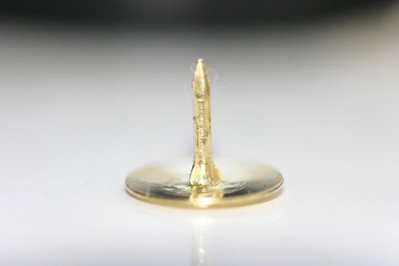

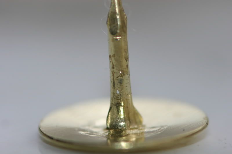

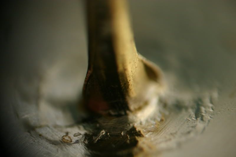

Jul 20, 2008 12:30 |  #11
you are right there when i took some pictures with the reversed 18-55mm the picture was kind of dark and also the depth of field was pretty bad.
however i got a 2 x convertor on the cheap and tryed that too.
heres the samples of a drawing pin i took.
sample 1 - just the sigma 105mm.
IMAGE: http://i3.photobucket.com/albums/y99/picardo/IMG_4513.jpg
sample 2 - sigma 105mm & 2 x convertor ( 210mm macro)
IMAGE: http://i3.photobucket.com/albums/y99/picardo/IMG_4505-1.jpg
sample 3 - sigma 105mm & 18-55 reversed lens.
IMAGE: http://i3.photobucket.com/albums/y99/picardo/IMG_4514.jpg

The higher your magnification and the longer your lens focal length, the shallower your DOF will be. It begins to get razor thin above 2:1. You'll either need to work with that or stop down your primary lens a lot to get back some of the DOF, slowing the shutter speed and/or upping the ISO to compensate, and possibly using a flash as well.
Any lens weaknesses will be greatly magnified right along with the subject matter. That's another reason zooms aren' t usually very useful for reversing (in addition to the smaller max aperture of the reversed lens and resulting dimmer viewfinder you'll need to deal with).

The teleconverter example shown is better than I'd have expected.
I'd still be inclined to try extension tubes instead.
