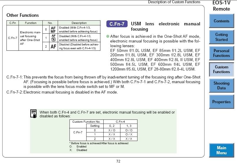

Naturally I never have my camera handy to check this out when in this thread... I know it works on the 85L since it's a "focus by wire" system. Doesn't make sense that FTM lenses wouldn't be affected since others require physical toggling of the AF/MF switch to engage/disengage the focus mechanism. FTM lenses must have an internal "soft switch" or something.
This feature has been around since the 1v at least. From page 102 in that manual; C.Fn-7 (USM lens electronic manual focusing), settings:
0 AF/MF
1 AF, no MF
2 AF
...on setting "1" states, "This prevents the focus from being thrown off by inadvertant turning of the focusing ring after One-Shot AF. (Focusing is possible before focus is achieved.) With both C.Fn-7-1 and C.Fn-7-2, manual focusing is possible with the lens focus mode switch set to MFor M."
...on setting "2" states, "Electronic manual focusing is disabled in the AF mode."
I use the * button as well. One of the first changes I make to any camera. Obviously enough people did this for Canon to come up with the "AF On" button of the Mark IIIs, heh.

Double Negative wrote:
I know on the 1Dxxx series there are several options; normal, off and MF off after AF (I use the last setting so as not to inadvertently change focus after I've AFed). Set via C.Fn.
timnosenzo wrote in post #6021372 (external link)
Really? I always figured that FTM on USM lenses was a function of the lens more than the body (except for on the 85L). So with that custom function enabled, one the camera achieves AF, the focus ring doesn't do anything?
Some EOS cameras have this unusual CF that gives you "ELECTRONIC FOCUSING" options that only work on some lenses that have Electronic Focusing.
The early Ring Type USM was slightly different than the USM we have today. It was used on only on a few older lens designs and some longer telephotos.
These are electronic focus ring USM lenses which can only focus manually when the camera is actually turned on. This is because turning the focus ring sends electronic commands to the lens motor, ordering it to rotate. The following lenses are old-style electronic full-time manual USM lenses:
EF 50mm 1.0 L USM
EF 85mm 1.2 L USM
EF 85mm 1.2 L USM II
EF 28-80mm 2.8-4 L USM
EF 200mm 1.8 L USM
EF 300mm 2.8 L USM
EF 400mm 2.8 L USM
EF 400mm 2.8 L II USM
EF 500mm 4.5 L USM
EF 600mm 4 L USM
EF 1200mm 5.6 L USM
msowsun
"approx 8mm"
9,317 posts
Gallery: 18 photos
Likes: 416
Aug 01, 2008 09:56 |  #15
IMAGE: http://i2.photobucket.com/albums/y17/msowsun/photo%20stuff/EOS-1VCF7.jpg
