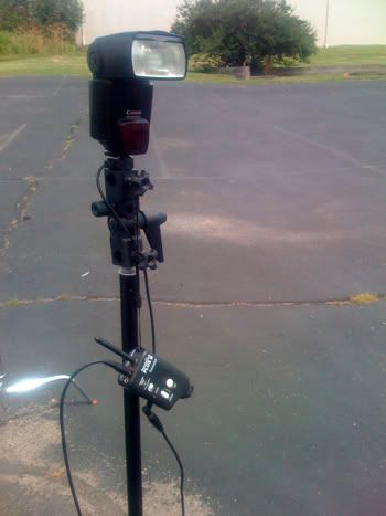

Answer....with pics
After talking to the engineer at our video production company, he explained why this was occurring. Both the 580EX and the Pocket Wizard Plus II are emitting radiation and both house oscillators. The flash has a DC conversion to power up for the amount it needs to flash. The closer you put the two introduces adding or subtracting from it's original field. In short, the 580EX is not shielded as well as the 420EX. Hence the 420 not having the problem. These were taken with my phone.
http://i39.photobucket​.com …166/jdavideo/IM​G_0219.jpg (external link)

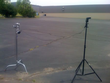

There are two ways to avoid this miscommunication....
1. Separate the two units as far as possible.
http://i39.photobucket​.com …166/jdavideo/IM​G_0221.jpg (external link)
This method worked well but not great. I was able to go about 50-60 feet.
2. Shield the flash unit. Since you don't want to shield the Pocket Wizard because it needs to read the Transceiver.
http://i39.photobucket​.com …166/jdavideo/IM​G_0222.jpg (external link)
Yes. This may look funny but it is THE solution. I was able to walk past the trees in the parking lot and it fired every time. The distance was around 200 feet and it seemed like there was no end to the range.
http://i39.photobucket​.com …166/jdavideo/IM​G_0223.jpg (external link)
So, this is what you get when you want to use Canon's next to best flash off camera. I only hope the 580EX II's are shielded better.
Thanks for your replies and I hope this helps anyone who's pulling their hair out like I did.
