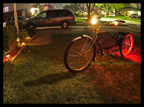

Brain fart time - I found a use for the AA holder from my BG-E2 and BG-E2N. If you have a Dyno Roadster with lights, 12 1.2v NiMH batteries will give you 14.4v (two holders wired in series). Not sure how much the batteries like 1.5A being sucked out of them.
IMAGE: http://mlav.com/blogpic/road042508-500-2.jpg
