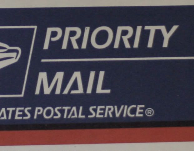

I have been quite disappointed with my real world results with the Sigma 30mm/1.4. I purchased this lense for low light use and have found it to be VERY soft wide open. Others on the forums and on review sites rave about how sharp this is, but I'm just not seeing these results.
Should I send it in for calibration?
Some examples (100% crops - sooc):
1.4
3.2
9.0

Hmm that wide open shot is pretty soft...have you tried taking any other shots?
My 30/1.4 looked like this wide open (center crop):
IMAGE: http://i12.photobucket.com/albums/a214/Mrvile/Sig%2030/center100.jpg

I recently got one and sent it back. It did tend to look quite soft wide open but that primarily seemed to be due to the backfocusing. If you stopped it down of course the DOF improved the image quality. I found the backfocusing was better near the closest focusing end than it was if you stepped back just a foot or two. I can't tell from this if you've got just a sharpness or focus issue but it could be either or both.
If the second one I get is no better I'm sending it in for calibration probably, I do like the lens but the quality control on these just seems to be so flaky.

Yes I did take other shots, these are not the worst of the lot, but I felt was the most realistic indicator.
Mine is also a centre crop. Yours is much, much better.

I doubt that's actually a soft copy. As others have said it's more likely that your copy is just front- or back-focusing (as many of them do from the factory). Just email/call them and they'll give you a form you need to send in with the lens. They kept mine (including the body, which I sent with the lens as suggested) for 2 days and then shipped it back and it's pretty much dead on now (although a shaky hand at f/1.4 will still leave you with soft images).

it looks like AF issue, similar to my copy. this sigma is sharp wide open.

I sent my 30 to Long Island for its third trip and got a call that it was fine on their 40D and that I would need to send my 40D to them to see if there was a problem. Since I didn't want to be without my body, I drove out there, and sure enough, they had to re-calibrate the lens.
It should be sharper than that wide open, but I agree with others to make sure that it's focusing correctly.
As for cost, it's free. Their service is really top notch. Another guy came in with 3 VERY old Sigma lenses (out of production for 5 years or so) and the quote that I overheard them tell him to fix the AF in 2 of the lenses plus tighten up the barrel on the third, was $150 for all three. That is really really cheap.
