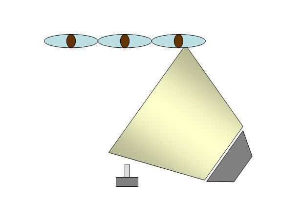

If you set the two studio units appropriately with diffusers, a third light does nothing for illuminating the subjects any better, except cast more shadows and create harsh edges on them!
Simply set one of the AB's as fill (near camera) and the other AB as the key light, and aim the key light so that the nearest people are 'feathered', like in the illustration.
