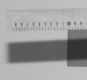

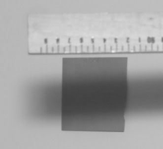

This illustrates my point about size affecting shadow presence. First photo is flash lens only, second lens has a diffusing paper (bond) in front and exactly the same size as the lens, and the third has a 5x7" softbox in front.
IMAGE: http://i69.photobucket.com/albums/i63/wiltonw/Lensonly.jpg
IMAGE: http://i69.photobucket.com/albums/i63/wiltonw/Papercover.jpg

Hermes,
Look at my illustration of effect of a lens (photo 1) vs. effect of diffusion (photo2) ...the diffusion offered by the paper softens the edges of the shadow. If you had put the wide lens over the flash, the total area of illumination changes but the shadow edge is fundamentally the same as without the wide lens, because it is still focused.
The diffusion effect of the paper is that (if you treat the paper as a grid of 10000 light emitting points) from each of the points on the surface of the paper, light is going out in all directions. That is the 'random' nature. Diffusion in liquid says that a dye would randomly disperse if you dropped a single drop into the water...and after enough time it is 'in all directions'
