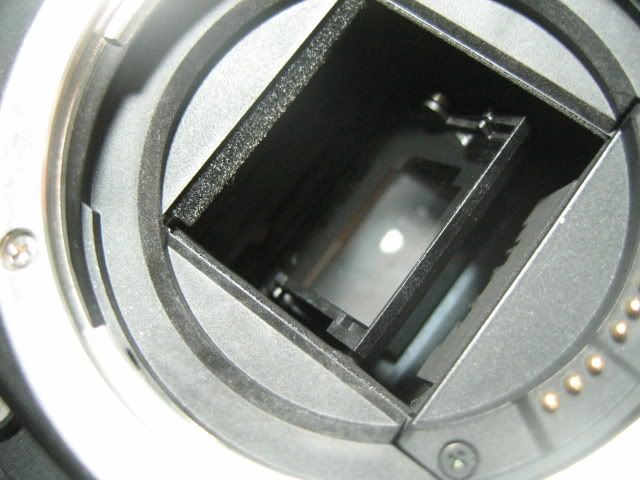

Hope this is the right forum, been taking photos on my XTi and I noticed a darker smudge in the corner of photos with skies. Its not really visible in other photos and I tried different lenses so it's the camera. http://i4.photobucket.​com …/Vivieri/asfnnk​streak.jpg (external link)
Someone suggested mirror-locking and checking for hairs and, ahoy, a cat hair in the back! Got that out and haven't been able to check if that was the problem BUT! I did notice a white mark here http://i4.photobucket.​com …y137/Vivieri/IM​G_9501.jpg (external link) (upperleft of the light reflection)...dried water? dust? a scratch? Can I use anything to try and get it out?

Nothing on the mirror or the focusing screen can affect an image (except for possibly buggering up the autofocus or auto exposure systems).
What you see in your image is either from some stuff deposited on the image sensor (actually a glass anti-aliasing filter in front of the sensor) or from a damaged shutter.

That pic you linked, the second, is of a shot of the mirror. This has no affect on your image. Use the sensor cleaning feature and take a look at the sensor (in a dust free place of course). If you see anything, try to blow it out with a Rocket Blower.
