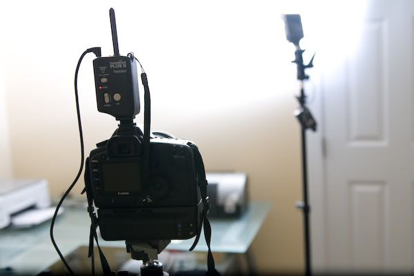

Here are some pic's of my set up when I want to use the 580EX on a flash bracket and the Sunpack's off-camera fired via the pocket wizards. The PW plugs into the sync port of the camera. I've attached an extra hot shoe to my flash bracket to hold the PW. If I just want to use off camera flash, the PW attaches to the hotshoe of the camera.

and here's a shot of some testing I was doing with a remote camera syncing with an off camera flash all fired via pocket wizards. It wasn't always successful. I need to get a different remote cable (PW to camera remote) to make it work.

Very well. That explains it. Thanks so much for your help.
Now, the cable that attaches from the camera to the pocket wizard...purchasable separately, I assume? You claim yours yours wasn't realiable, but, did you find a 'better' replacement? Given I don't have a remote trigger for the cam, I suppose the corded switch that I do have will suffice...for now.
Again, I really appreciate it, and now, with the flash bracket in the equation, it makes so much more sense. As a result, you basically have a portable 3 flash solution. Very cool.
Oh, one more question...the transceiver stays close to the camera. Have a picture of the 'receiver' over there, on the light stand? Thanks again....really do appreciate all the help.

My camera cable was reliable for it's intended purpose which is to fire the camera. However, I've learned that I need a different cable if I want to sync the remote camera to a flash via the main camera. What I was trying to do was to fire two cameras and have both sync with my flashes.
The pocket wizard is connected to the flash via a short sync cable. You can kind of make out the receiver on the light stand, hanging by it's strap. I've since added some pocket wizard caddys to make things a bit neater.
