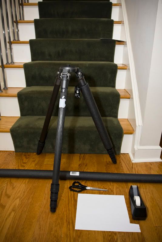

I recently purchased a new Gitzo GT3541XLS and was wondering if anyone could help me with a decision between lenscoat/optech tripod pads when someone said why don't you make them...
- This will mostly be geared toward Gitzo but the same can be applied to any other tripod
-This is incomplete do to I have to shop around for a nylon fabric I like so this is just for the pads
PS the apple sticker is now a tradition ( I had a smaller one on my Manfrotto so a bigger on on the Gitzo )
So here we go...
Time to complete: (If not taking photos=D) = 15 minutes tops
Total cost (not including tripod) = $1.42 including tax =D
Materials needed:
- Tripod
- Change from their pocket
- A local hardware store that carries PVC pipe insulation (I think thats what it's called?)
- Clear tape (It's the smoothest)
- White computer paper (If you can think of something better let us all know)
- Scissors

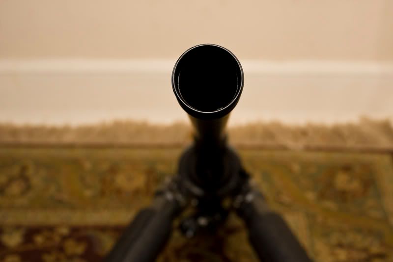

IMAGE: http://i57.photobucket.com/albums/g213/wallybud/begin.jpg
1. Take your tripod to the store and check out the section with the PVC piping. Find the insuation (foam that wraps around it). They will have three different kinds - One is a regular foam covering with a perforated line down the side (it should NOT be cut all the way - That is the one I chose), The other will be a rubberish material with sticky joins to seal it, and the last will be the regular foam (however this one is cut and with stickies)
- See which size will fit nice an firmly around your top section (it cant be WAY to tight or you'll never be able to slide it over the threads without the perforated cut splitting open)
- Purchase the correct size and drive home =D ... On the way home you'll get excited that your saving money and having fun while doing it - This IS normal
IMAGE: http://i57.photobucket.com/albums/g213/wallybud/price.jpg

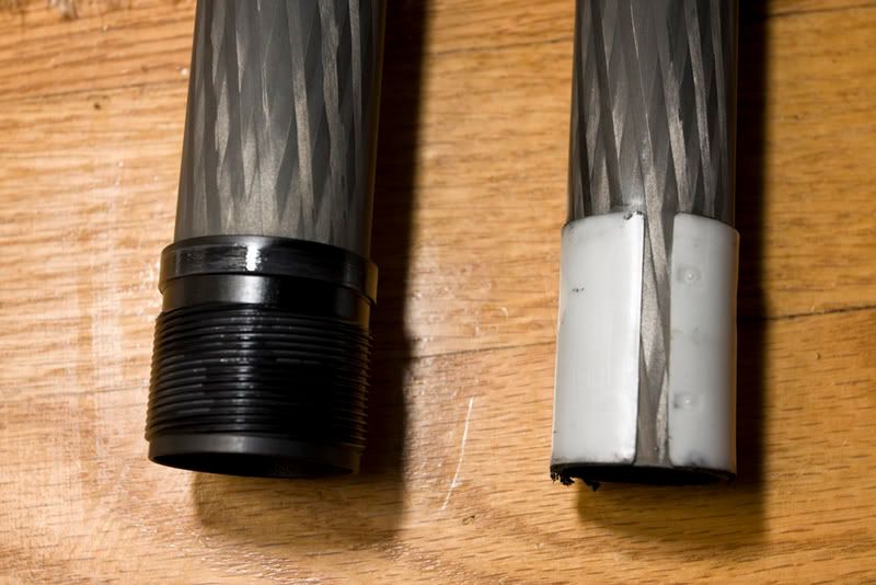

2. Find a nice space to settle down with all your stuff and unscrew your tripod leg all the way - Slide it out...NOW a couple things...
- The part you are unscrewing will be free sliding on the section you have removed. Normal
- You'll see two white pieces at the end of the section you have removed. Normal
- Things will be greasy. Normal don't rub any grease off...
IMAGE: http://i57.photobucket.com/albums/g213/wallybud/takeout.jpg
IMAGE: http://i57.photobucket.com/albums/g213/wallybud/bothinsides.jpg

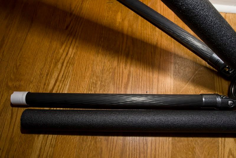

3. The length of the threaded part of your tripod is the size of the paper you cut (look at the photo). Then wrap it TIGHTLY without letting it slide all over an rub off the grease. Put a nice piece of tape around the paper. OK now that the paper is all in place you can slide a piece of foam over it without rubbing of the grease.
IMAGE: http://i57.photobucket.com/albums/g213/wallybud/paper.jpg
- Lay the insulation next to the leg. Put your finger at the spot you wish to cut and cut the correct length (without cutting off your finger - it'll be SO messy)
IMAGE: http://i57.photobucket.com/albums/g213/wallybud/measure.jpg
Slide the foam over the paper end slowly (the foam shouldn't rip - it may make a SLIGHT tearing sound but thats fine)
DONE....Syke now you have to put it back together...This can give you problems unless you pay attention

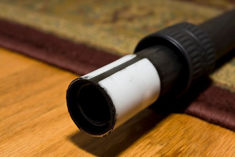

4. Now What your going to do is slide the one leg back into the other - EASY right? NO haha...This is what you'll be looking at -
Male Part
-The two white things have to be held while doing this or they - A. Won't go in right or B. will fall off the leg haha
-If they come off which they 100% will...there are two little bubbles that tell you exactly how they go
IMAGE: http://i57.photobucket.com/albums/g213/wallybud/Whitethinghole.jpg
Female Part
Has two slits on the inside that have to match up with the two spaces between the two white pieces on the other leg (confused? - I hope not =D)
IMAGE: http://i57.photobucket.com/albums/g213/wallybud/Hole.jpg
OK Line them both up and slide it in like a half an inch - It won't let you go any father - Spin it around until you feel a little click (its not going to go right in but once you feel something you know you're there - So now squeeze the white things against the leg and try to wiggle it in. Got it? Almost? No? Ok try again =D
- It will take you a coupe minutes to get the first one back in there but the next two should be a breeze
OK So I hope you enjoy this Wallybud production - It is my first documented DIY How'd I do?? If there are any misspellings ignore them - I'm a horrible proofreader!

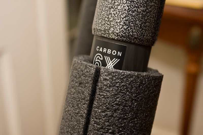

PS Here is the results of your hard work - now the clean up
IMAGE: http://i57.photobucket.com/albums/g213/wallybud/Final.jpg
IMAGE: http://i57.photobucket.com/albums/g213/wallybud/6X.jpg
