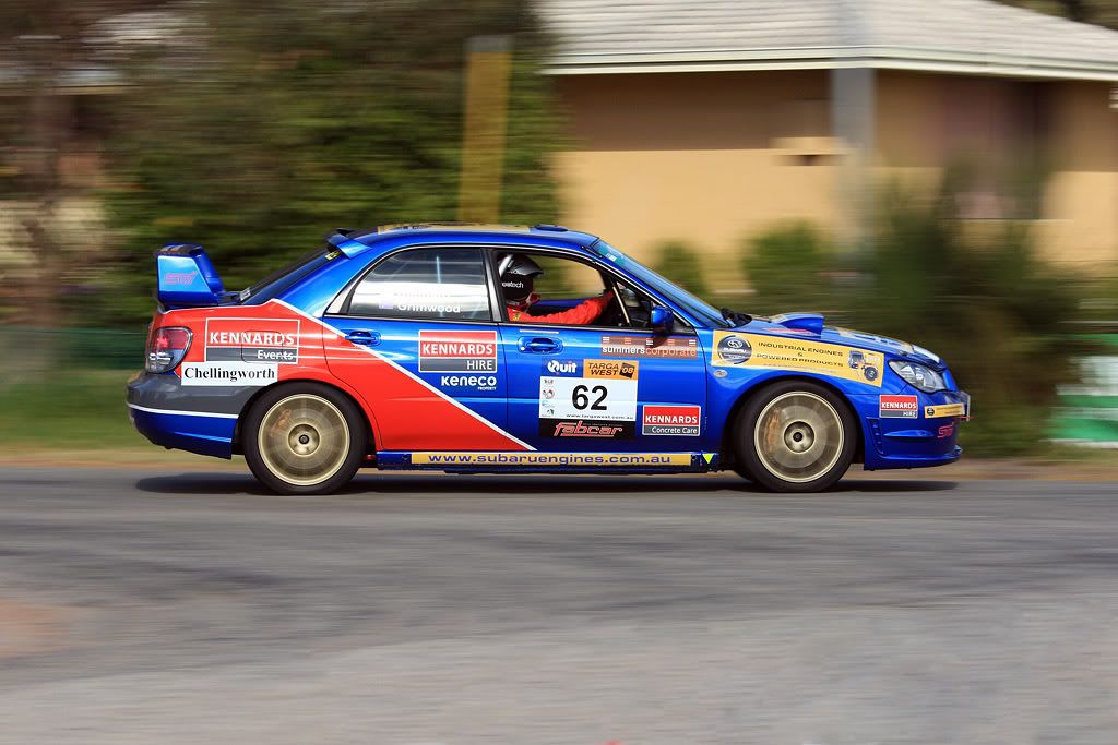

just so you know it isnt just you - im new to panning too and got the same result - hope you dont mind me posting... i had a feeling it was due to rotation... but good to get a clear description - thanks...
IMAGE: http://i235.photobucket.com/albums/ee188/supernicko/a2.jpg

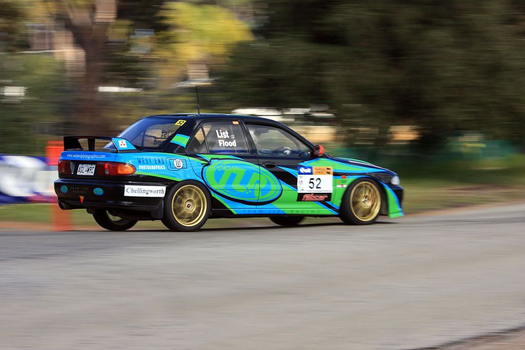

and then here the car (wrx) was dead side on - and its all in focus...
IMAGE: http://i235.photobucket.com/albums/ee188/supernicko/a3.jpg
