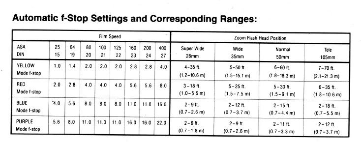

You are doing something wrong. With ISO 100, your aperture should always be f/4.0 if you are using the RED auto setting.
If you are using ISO 100 f8 on the RED setting, it would have been underexposed, not overexposed.

Thank you for that chart msowsun . Printed it and it's in my bag .

The chart is from the 285HV manual: http://www.cameramanua​ls.org …_meters/vivitar​_285hv.pdf (external link)

:oops::oops: I have the Manual , not sure how I missed it .
Thank you all the same . :oops::oops::oops:
