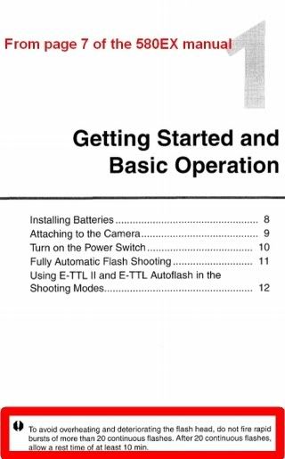

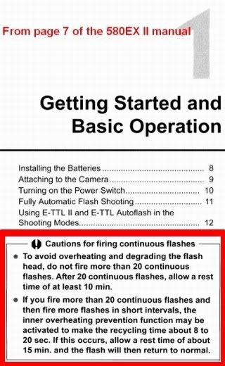

Sep 16, 2008 07:10 |  #20
Wilt wrote in post #6309435 (external link)
But the 580EX has never claimed to have any thermal protection sense and activation.
This is Page 7 of the 2 580EX manuals .......
IMAGE: http://i2.photobucket.com/albums/y17/msowsun/photo%20stuff/page7Overheating580EX_320.jpg
IMAGE: http://i2.photobucket.com/albums/y17/msowsun/photo%20stuff/page7Overheating580EXII_320.jpg

Sep 16, 2008 07:38 |  #21
CliveyBoy wrote in post #6315355 (external link)
580EX II manual: "To avoid overheating and deteriorating the flash head, do not use stroboscopic flash more than 10 times in succession. After 10 times, allow the Speedlite to rest for at least 15 min. If you try to use the stroboscopic flash more than 10 times in succession, the firing might stop automatically to protect the flash head. If this happens, allow the Speedlite to rest for at least 15 min."
I took it that "stop automatically" meant specific provision, and not simply "fail". I would expect such provision to be made, and this may have coloured my reading.
As msowsun's post shows, too many continuous bursts -- not merely stroboscopic usage -- can damage the flash if not given a period of rest. I had not seen that 'stop automatically' wording, which I'll admit might connote a protection circuit.

Sep 16, 2008 16:58 |  #23
MSIGuy wrote in post #6318437 (external link)
Might? No, defiantly.
It appears that the 580 had NO protection, but the 580EXII added the protection!
Canon must have realized how many users never read the instruction!
