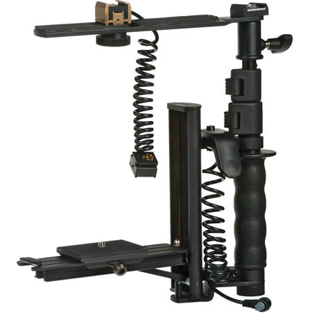

Sep 27, 2008 18:14 |  #11
anyone used this one?
IMAGE: http://www.adorama.com/images/large/FABTTLEOS3.JPG

Sep 27, 2008 19:07 |  #13
cbr929rrerion wrote in post #6393118 (external link)
I'd check the rotation of that one for sure.

Sep 27, 2008 19:09 |  #14
the camera moves not the flash...

staffer
106 posts
Location: Ottawa, Canada
Sep 27, 2008 19:10 |  #15
I've never used the Dot Line brackets so can't comment on them. That said, the telescoping flash arm looks useful, but there doesn't appear to be a mechanism whereby the flash can tilt upwards or downwards(in your preferred position). At a longer extension, you may want the flash to tilt down for better coverage.
Stroboframe makes a camera rotating bracket that allows the flash to be raised and tilted within a certain range.
