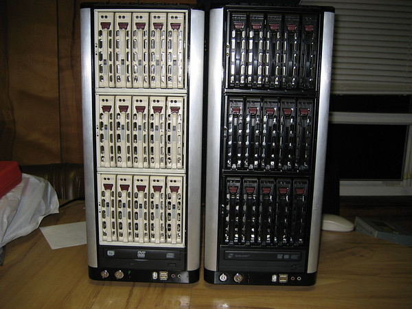

I've been in the computer industry for many years now and Digital Photography for about 5 years or so. I've dealt with hard drives failures many times and know that you can't depend on a single drive ever! I've had a new Seagate drive die on me within days of putting in to service.
As for backup solutions this my friends is really the holy grail of computing these days. As mentioned hard drive capacities are growing so quickly. Seriously I just bought my first 1.5TB Drive on Friday!!! At the same time none of the "Backup Solutions" are anywhere near these capacities.
Over the years I've tried many backup solutions and found that CD's and DVD's just aren't reliable but do offer a good online solution if need be. I have never had any luck with tape no matter how many solutions I've tried. I admit that I've never tried any enterprise level solutions and probably never will since this is only for personal use.
With that said I keep all of my Digital Content (Audio / Video / Photo) on two different RAID 5 Servers that I built (see below). Each of them are expandable to about 20TB using new 1.5TB drives. For extra piece of mind I also use an online backup company (Cabonite) for all of my Documents and Photos.

What's the cases and drive enclosures?

The Case is an AeroCool Masstige
The SATA Enclosures are 3 - Super Micro CSE-M35T-1B (for the black ones)
If you built something like this make sure you have a big enough power supply to handle all of the drives. The other way around it is to make sure the RAID Controller supports Staggered Spin Up. I am using a 3Ware 9550 which does.
