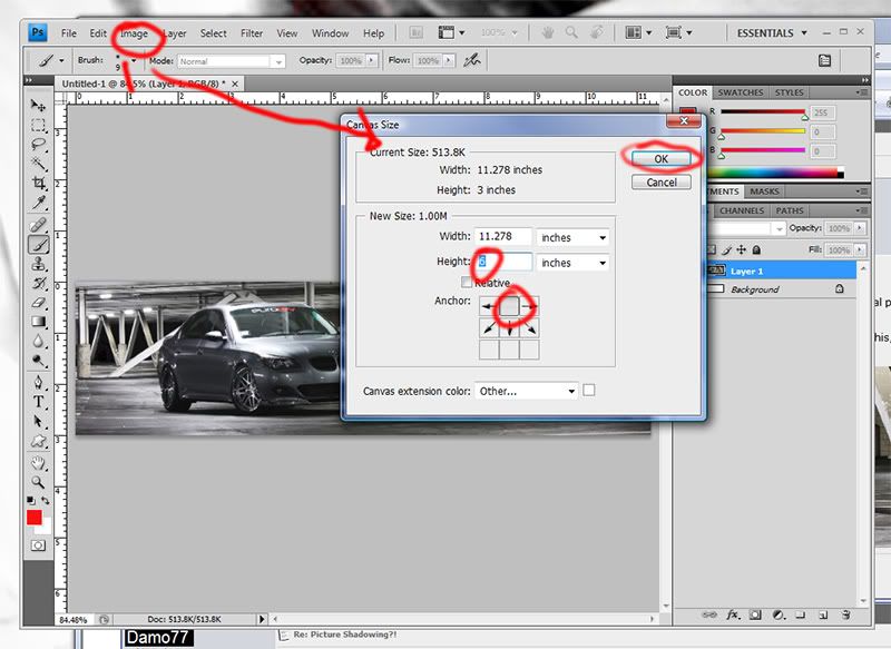

try this, if you didn't get it already.
change your canvas size. Duplicate the image (ctrl+j) flip it vertically (edit > transform>flip vertical)
IMAGE: http://i265.photobucket.com/albums/ii214/abaum565/canvas.jpg
add a layer mask. Select your gradient tool (make sure its on a linier gradient) change color pallete from black to white hold shift and drag up.
