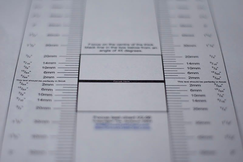

And this test shows that it works fine... :confused:
Shot with 50mm at f/1.8
IMAGE: http://img.photobucket.com/albums/v215/newton22/IMG_9929.jpg

Not as a feature in the cam, but on test sheets there was (like the one he just supplied).

The fact its odd on the 30d leads to 2 possible issues. Possiblilty number one is that the 30d is in fact back focusing, but your focus chart does not indicate that (although that depends on you getting the 45 degree angle right). Possibility number two is that you use the 30d differently and this contributes to focus errors, if its a new camera to you, that could be more probable.
