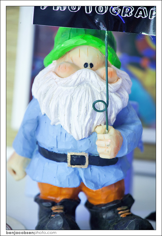

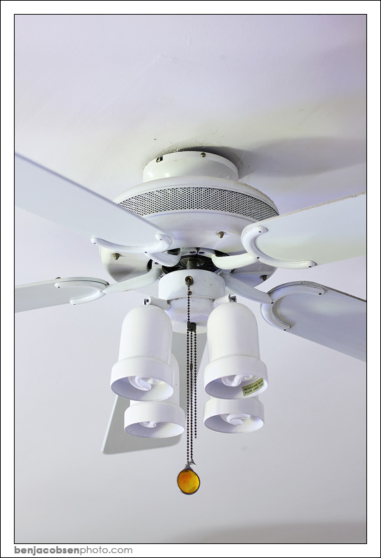

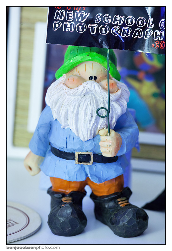

I was doing a lens test for my site with the 100-400 -vs- 70-200. The later having a 1.4 TC and 2.0 TC on it... But the interesting thing is when shooting at in between numbers in their zoom range, or even at the ends, the images are waaaaaay off.
Here's a few examples:
jacobsen1 wrote in post #256694 (external link)
400mm, 100-400 left, 70-200 f4 w/ 2.0 TC right:
notice the 70-200 w/2.0TC @ 400 is MUCH longer than the 100-400!
f8
that's a 100-400 @ 400 and a 70-200 w/2.0TC @ 400... that's not even CLOSE to the same IMHO.... Which is really 400?
jacobsen1 wrote in post #256658 (external link)
100mm (70-200 on left, 100-400 on right):
(also not, the 70-200 is at 97mm, but CLOSER than the 100-400 @ 100)
f4.5
again at the wide end... the 70-200 was at 97mm (my best guess as to where 100 was) and the 100-400 @ 100 was actually WIDER?!
I'm assuming this is because the FLs used in lens naming are more approximate than exact, but does this fall in line with what anyone else is seeing? Which one of these setup is closer to 400 out of curiosity?
if you want to see the full image test, go here (way too many posts to repost here, sorry):
http://www.newschoolof​photography.com/forum/​showthread.php?p=25665​8 (external link)
for me the 100-400 wins, but all 3 lenses tested are fantastic.

Try the comparison at infinity focus. Does the 100-400 change lengths on zooming?

The focal length is always specified at infinity....focussing more closely will reduce the focal length.
Secondly, the 100-400 is normally around 380mm max and the stated Fl is "nominal".

It also has to do with whether the lens extends on zooming. My Sigma 18-200 extends, whereas my 200 f/2.8L does not. At infinity their fov is the same; inside that the Sigma's fov is wider.

I doubt the TC is exactly 2x to the mm, it is probably a 1.98 or a 2.05 or something. Adds up to a few mm when you times it by 200mm

but this difference at 400mm isn't what I'd call small....
Canon Bob wrote in post #7165090 (external link)
good point, and this was all at <10'... Plus with the 100-400 extending, that probably makes it worse.
