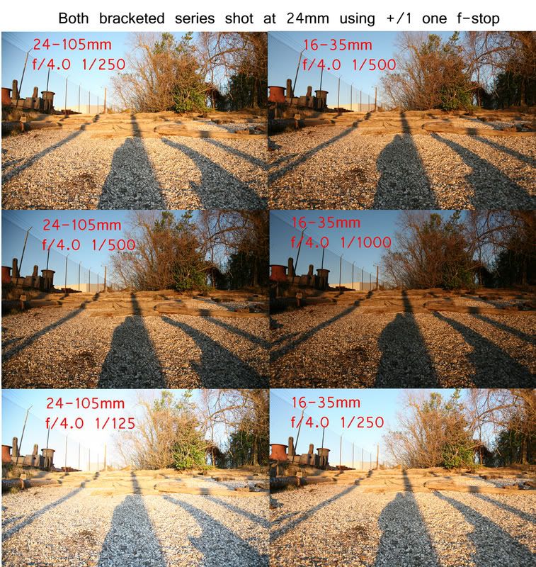

I was like a kid on Christmas day when UPS showed up with a new 24-105mm f/4.0L lens today. This lens was intended for my new-to-me 5D body.
Needless to say, I was immediately disappointed at the results. All of my exposures, no matter the ISO, shutter speed, or aperture setting seem to be overexposed by about 1+ stop; maybe even as much as 1 and 2/3rds.
At first, I couldn’t believe my eyes, so I tested it with the 16-35mm f2.8L at the same focal length. Then I went to a friend’s house and had him look at it too. We even tried his 17-40mm f/4.0L at the same focal length. Same results… the new 24-105mm is overexposing. I tried everything I could think of, including resetting all of the 5D’s settings back to factory default. But I'm still having the same issue. Your comments/suggestions would be greatly appreciated.
Below are results of a side-by-side comparison that represents tests with the other lenses we tried.
IMAGE: http://i44.photobucket.com/albums/f20/phi376/24-105mmf4L-overexposureissues1200X.jpg

Feb 02, 2009 20:35 |  #2
why are you using 2x the shutter speed on the 16-35?
is this on manual?

Feb 02, 2009 20:36 |  #3
Those are not lined up right for comparison.

Feb 02, 2009 20:40 |  #4
My fault. Let me start over. I don't think I explained this correctly. Rather, I should have said that my 5D is metering light differently between the 24-105mm and all of the other lenses I try. As a result, all of the exposures are overexposed by at least one stop.
I hope that explains my problems better. Sorry about the confusion.

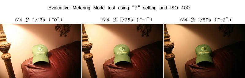

IMAGE: http://i44.photobucket.com/albums/f20/phi376/FocusingScreenTest.jpg
From below, I think you can see that the ideal exposure is somewhere between “-1” and “-2” stops.
