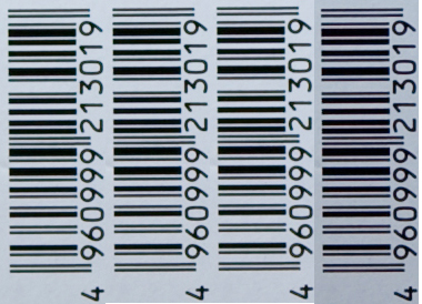

The full picture
IMAGE: http://www.anderssonbros.com/photofolder/50_MAN1_size.jpg
I aimed for the barcode in the center of the box

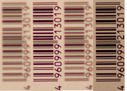

IMAGE: http://www.anderssonbros.com/photofolder/50_resultat.jpg

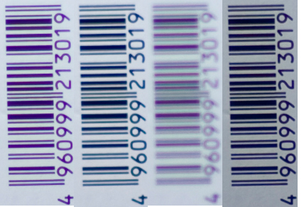

As I was stunned I repeated the test again with the following result
IMAGE: http://www.anderssonbros.com/photofolder/50_resultat1.jpg
Well, what can you say... :eek:
I tried the same set up with my 24-105, set at 50mm and f4
IMAGE: http://www.anderssonbros.com/photofolder/24-105_test2_resultat.jpg
seems OK...
One should note that when using a faster lens, like the f1.4, the camera is also using the 6 invisible AF points.
The guy with the two 5DmkII bodies had them both realigned at Canon service and after that - all OK
My 5DmkII body is going back for realignment next week!
(FWIW, I also tried the 50/1.4 on my 40D the same way as above with perfect result)
Anyone else having problems with focus shifting??
It feels like a bad quality control issue......
