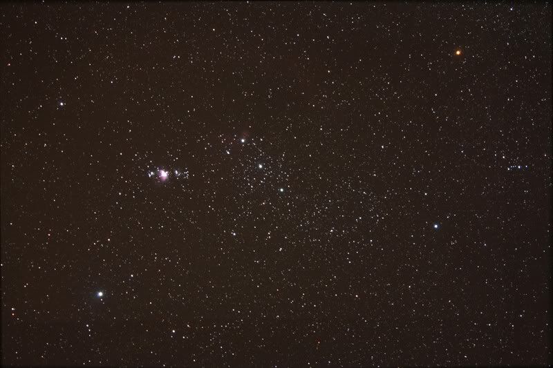

I got the Vista Starstepper up and running, and I also borrowed a nice Canon remote from a coworker of mine. Finally got everything to work out tonight. These were 20 4 minute exposures for a total of 80 minutes, 55mm, f/5.6 800 ISO. I am clamping the poor starstepper to an old TV stand, and so alignment was through trial and error for about 45 minutes. Still had some drift, but not too bad. I didn't feel as though it was focused as sharp either, but I've been struggling with that as well. In any case, this is the best I've done so far. I can not only see the Orion nebula, but also the running man, the Flame, and the Horsehead as well. I can even see a little bit of Barnard's loop starting to peek through at the top of the original stack. I tweaked it a bit, but I just don't know how to make it shine to its full potential yet. Enjoy!

Excellent widefield. I'll be giving this a go some time.

Nice widefield. At 80 minutes total I would have expected a bit more background nebulosity, How are you stacking and processing?

That's a lovely shot, framed really well and the nebulosity is peeking through. Bravo!

Chris, no darks or flats at all. I used DSS, and post-processed in PhotoStudio 5.5, a program that came with my S1 IS. I'm thinking I might grab a few dark frames, and I am going to try again in Gimp. This is a JPEG, and then moved to Photobucket, so I know I lost a little bit. Even in the original TIFF image, I can't see a lot of the nebulosity. I was shooting in JPEG and AWB.

Yeah I would probably not bother with darks or flats but may be tempted to shoot RAW for DSS.
I was just a little surprised that for an 80 minute total exposure that a little more of a hint of Barnards Loop was not showing through. I had a quick play in Photoshop and couldn't stretch it much more either.

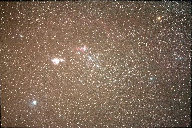

I played with it in Gimp, and was able to squeak out a little bit more, but it just looks soooo noisy and not clear and crisp like other images I see here. I must say the learning curve is quite steep. Good thing I'm not afraid of heights. LOL

If it was easy it would be no fun at all. Astro images are amongst the most challenging to post process. Your second image shows the loop and the nebulsity that hangs around Zetoa Orionis (Alnitak). There is also a lot of other faint stuff so somewhere between your two images is probably about right.
