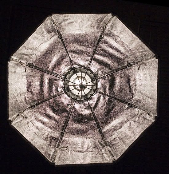

The PCB Octa is slightly thinner material than the Nova but once its put together and locked in place its very sturdy and solid feeling.
Here it is without any diffusion in place.
IMAGE: http://i207.photobucket.com/albums/bb212/epatt250/tests/IMG_4806_3251.jpg

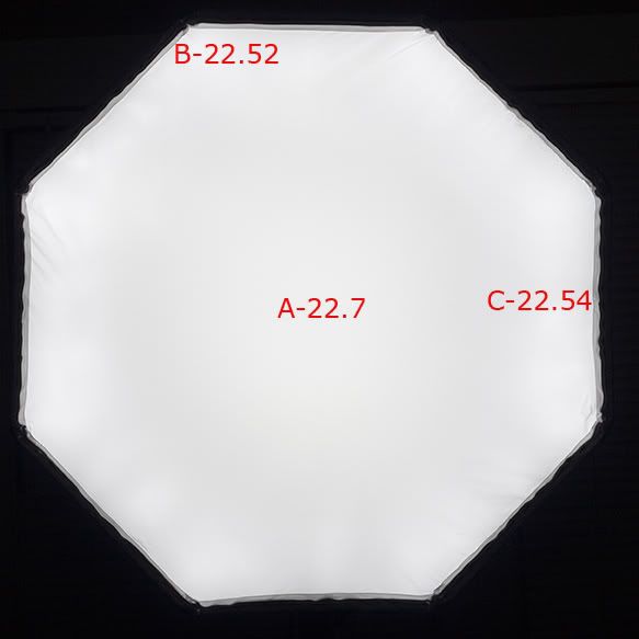

Here it is with both diffusion panels put in place and with some light.
IMAGE: http://i207.photobucket.com/albums/bb212/epatt250/tests/IMG_4821_3252W.jpg
Note that the F numbers provided are NOT for the exposure you see in the image above. I had to turn my AB800 down to 1/32 to get it dim enough to not be blown out. The numbers you see are an average of 5 meter readings at 1/4 power setting. Meter was 1" from the fabric and at the edges was 1" from the outside edge.
I took 5 readings at each location to account for inconsistencies. The actual readings were as follows.
A-Center
22.7
22.7
22.7
22.7
22.7
B-Upper Left Corner
22.6
22.5
22.5
22.5
22.5
C-Far Right Edge
22.5
22.5
22.6
22.5
22.6

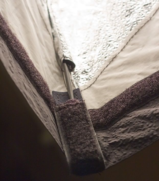

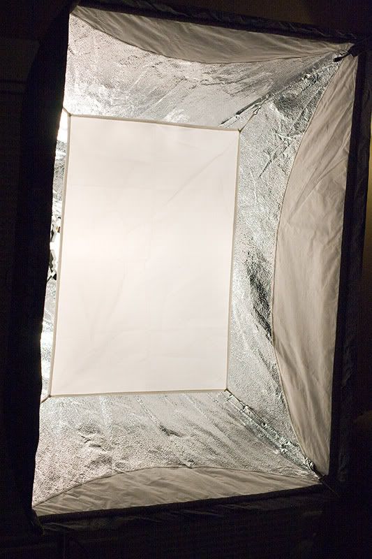

The Calumet Nova box seems to be built with a little bit thicker material and the stitching looks a bit thicker.
HTTP response: 504 | MIME changed to 'text/html' | PHOTOBUCKET ERROR IMAGE
IMAGE: http://i207.photobucket.com/albums/bb212/epatt250/tests/IMG_4833_3255.jpg
IMAGE: http://i207.photobucket.com/albums/bb212/epatt250/tests/IMG_4829_3253.jpg

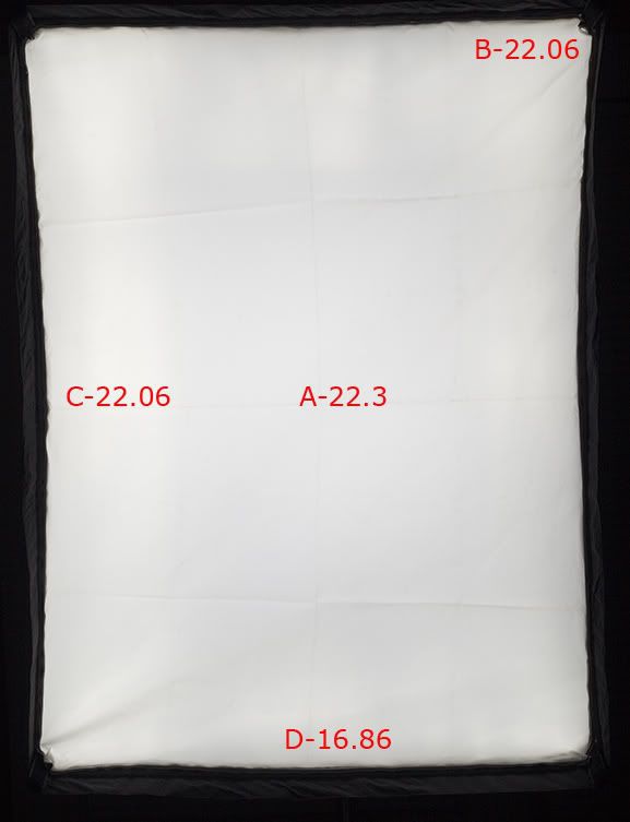

IMAGE: http://i207.photobucket.com/albums/bb212/epatt250/tests/IMG_4840_3257.jpg
The actual numbers on the Nova are as follows.
A-Center
22.3
22.3
22.3
22.3
22.3
B-Upper Right Corner
22.0
22.1
22.1
22.1
22.0
C-Far Left Edge
22.0
22.0
22.0
22.1
22.2
D-Far Lower Edge
16.9
16.9
16.8
16.8
16.9
Note that the power slider was not touched between the meter readings of the 2 modifiers.
