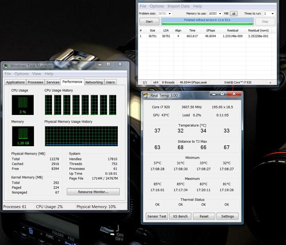

Well in fairness, I have to admit that I went and got linx a alternative front end for linpac. I have no idea why but it DID place more load on the CPU than Combining prime95 and IBT.
In fact the temps got past my comfort zone and I stopped the first run at 85C when it showed no signs of slowing down.
I dropped my CPU speed to 3700 and dropped the voltage 1 notch. This time I let it run and it finished a run of LINX and two cores just touched 85C. No higher. It finished with out errors.
I had my case buttoned up tight with all the air filters in place. Tonight I will take the air filters off( good for 3C) and run all night to see how she goes.
So I need to thank you for finding a test that ran my machine even harder. I want every last bit of Stable safe speed but not one bit over that.
So in the end you did me a favor by introducing me to a better tool. For that I thank you. Even though you screwed me out of 100 MHZ LOL bw!

Feb 25, 2009 09:18 as a reply to  @ smcclelland's post |  #30
Well it passed 20 passes of LINX over night at 3600 ( 190x19) with a vcore of 1.375 top temp on the hottest core was 81.
It interesting. Its cooler but know more stable. My limit seems thermal.
Here is a question, running games, DPP and photoshop I never EVER get temps even coming close to approaching this. The temps at 3600, 3700, 3800, at CPU voltages up to 1.425 never climb above the mid 70's at 3800 and on average stay about 5 to 7C cooler at 3600. But the machine is faster at 3.8
Assuming that at 3800 the machine stays with in reasonable temp limts during use as defined by INTEL and remains stable and returns no calculation errors in testing..... why not run it this way?
So I guess the Question is assuming there is a envelope of performance that is OK for the PC as defined by official spec.
If you stay with in that spec at all times does it matter if you average 60, 70, 80, or even 90 percent of the Maximum allowable? Shouldn't your PC be able to run at 100 percent?
Once again LINX is really a tough test man... on my box at least 5c HOTTER than Prime 95 AND IBT running at once!!
