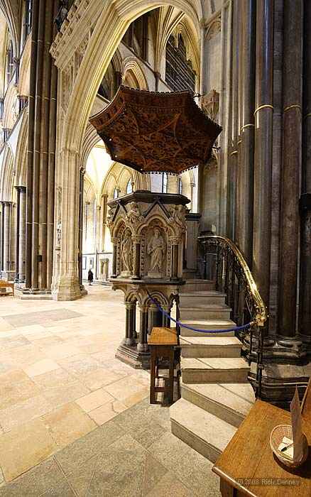

Feb 23, 2009 14:07 |  #9
Longer exposures are necessitated by less light reaching the sensor. That means the dynamic range of the illumination is down in the low end of the sensor sensitivity. Sensors may have some effects as a result, but actually I find that, apart from noise, they tend to be fairly linear in their response. Film, on the other hands, is a mess of non-linearity.
The main difference is that a long shutter speed allows a small aperture, and that affects the image profoundly.
This image was made at f/16 and 6 seconds.
IMAGE: http://www.rickdenney.com/IMG_0538_pulpit_lores.jpg
But for the extreme depth of field (12mm doesn't hurt here), there's nothing about the image to suggest the long shutter speed. With film, you might see halation or reciprocity error or color crossovers (where the shadows respond to the long exposure time differently than the highlights), but I don't really see any of those effects in this image.
Rick "who did have to clean up a couple of hot pixels, however" Denney
