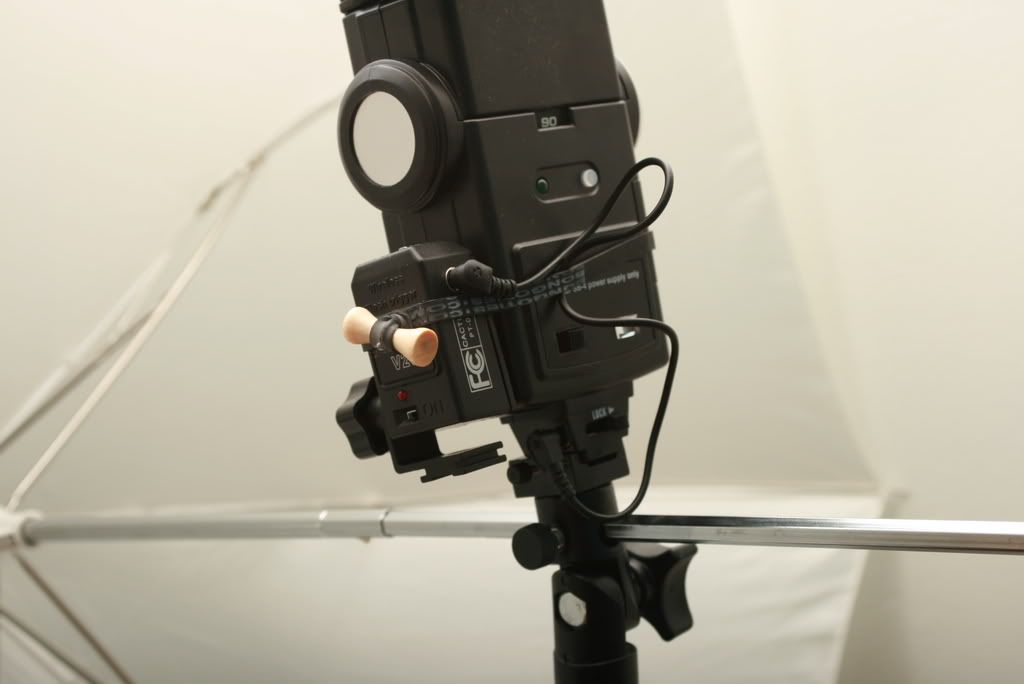

Another dumb question... Do I need to buy an adapter to screw the viv's on tripods? Or do they come with a foot like the 580?
Ryan McGill
My Gearhttps://photography-on-the.net/forum/showthre​ad.php?t=592450
jcp2000
988 posts
Location: California
Aug 28, 2009 13:46 |  #2279
they have a foot but you still need a umbrella bracket/adapter with a cold/hot shoe on it so it could mount to the stand like this.
IMAGE: http://i42.photobucket.com/albums/e340/jcp2000/setup001.jpg
Canon 7D, Sigma 24-70 f2.8 EX DG, Vivitar 285HV, AlienBees B800, Vagabond II, Cactus V2s, SLIK Able 300 DX
