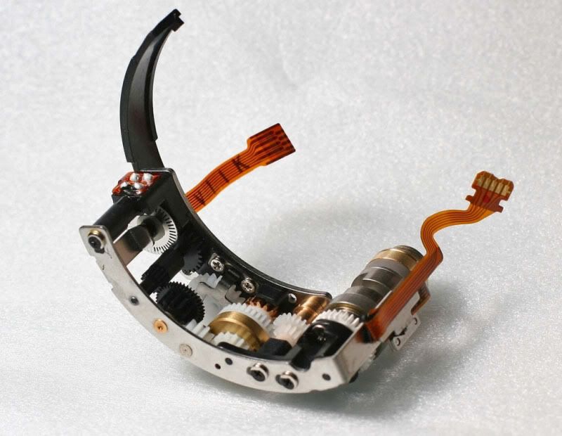

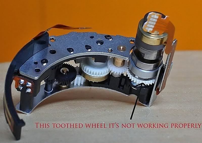

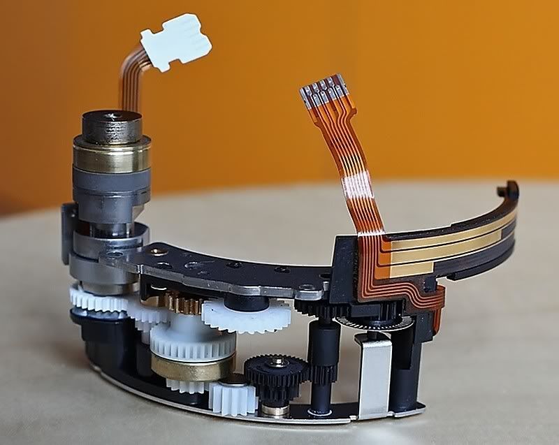

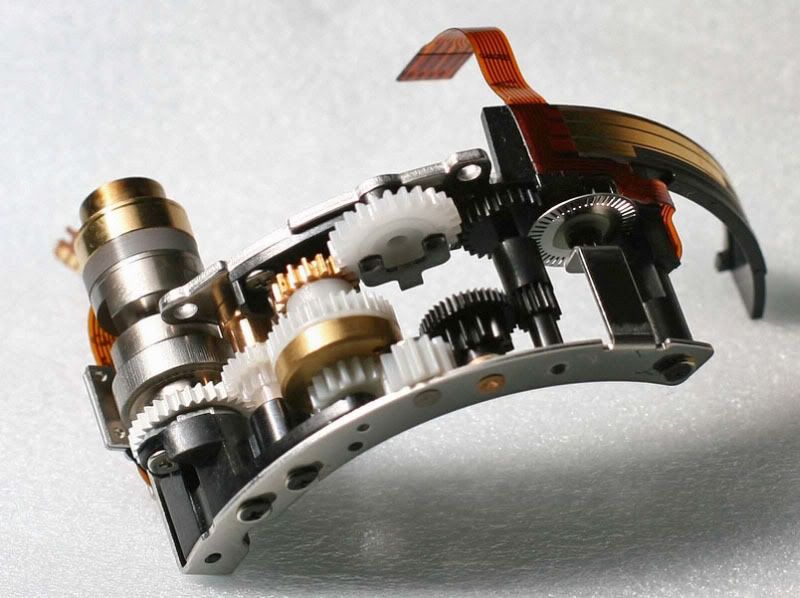

Thanks for the help all. Something else I discovered ...
manually focusing it (still in AF mode) there is very little resistance, but with the focus button (*) down there's more resistance and some jerky sensation. The motor is trying to do something, so it's definitely not the AF/MF switch. Occasionally it willtry to move about 1mm on it's own (while AF).
My guess is it has something stuck in the micro gears, and I'm not going to get it out on my own. Sounds like a trip to the repair store. :(
CHUCK
msowsun
"approx 8mm"
9,317 posts
Gallery: 18 photos
Likes: 416
Mar 10, 2009 19:25 |  #8
There are many gears in this lens. There is a clutch system which allows Full Time Manual focus even though it only has Micro USM.
IMAGE: http://i2.photobucket.com/albums/y17/msowsun/photo%20stuff/EF50mmclutchsystem_800.jpg
IMAGE: http://i2.photobucket.com/albums/y17/msowsun/photo%20stuff/EF50mmclutchsystem2_800.jpg
IMAGE: http://i2.photobucket.com/albums/y17/msowsun/photo%20stuff/EF50mmclutchsystem3.jpg
IMAGE: http://i2.photobucket.com/albums/y17/msowsun/photo%20stuff/EF50mmclutchsystem4.jpg
