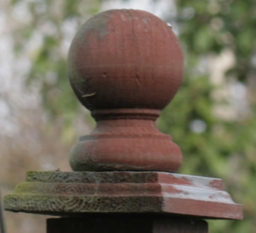

Vulcan58
1,790 posts
Location: Hampshire, UK
Mar 15, 2009 10:56 |  #13
Thanks for the answers etc.
For experimental purposes then - 2 pics, first Non IS, 2nd with.
Not exactly sharp images anyway, but done in haste just to prove the point.
IMAGE: http://i133.photobucket.com/albums/q54/maypole_photos/NonIS.jpg
IMAGE: http://i133.photobucket.com/albums/q54/maypole_photos/WithIS.jpg
