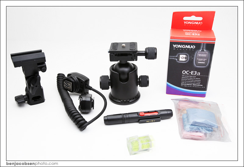

I ended up getting the dealextreme cheap ballhead. It was ~$50 and is exactly what I wanted:
IMAGE: http://gear.benjacobsenphoto.com/wp-content/gallery/accessories/img_4103.jpg
it works with my RRS plates provided I take the safety pin off (it's just a hex screw). The only weird part so far is as you tighten the ball that last bit to make it solid it moves the composition a slight bit each time. But for a $50 acra compatible head, I'll take it.

What's that on the left? Looks like a tilt head, but with an attachment for a light stand?

Apr 17, 2009 11:31 as a reply to  @ René Damkot's post |  #24
it's a cheap umbrella light stand deal.

Apr 17, 2009 13:59 |  #25
Ah, so that's a cold shoe on top, not something Arca style... I was confused for a sec.
