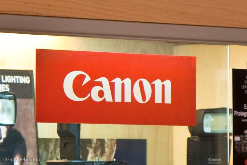

I've narrowed it down to the 40D or 50D, no 5D as I'd rather have the 9 cross-point sensors of the croppers. Of course the debate that follows these two is the ISO performance, so I headed down to Calumet today with a 4GB card and snapped some test shots.
All photos taken in RAW format with the 17-55mm f/2.8 wide open, and processed in LR2. Noise reduction set to 25% color 0% luminance because that's what I use realistically. I have the full ISO range for the 50D, and ISO 400 and up for the 40D. (40D metering set to spot, 50D metering set to partial, forgot to check that but my test still works)
50D
ISO 100
IMAGE: http://img.photobucket.com/albums/v222/gheb88/IMG_9516.jpg

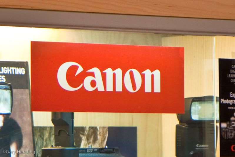

ISO 200
IMAGE: http://img.photobucket.com/albums/v222/gheb88/IMG_9517.jpg

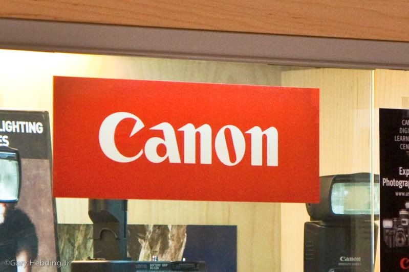

ISO 400
IMAGE: http://img.photobucket.com/albums/v222/gheb88/IMG_9518.jpg

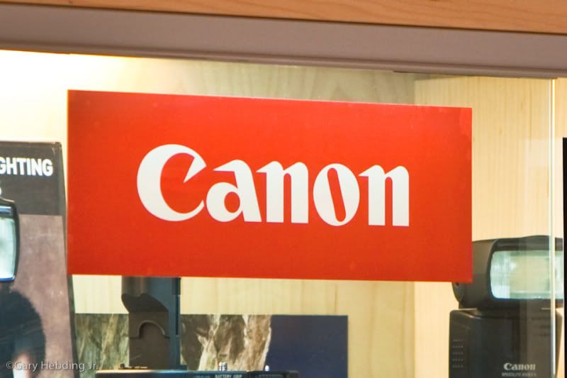

ISO 800
IMAGE: http://img.photobucket.com/albums/v222/gheb88/IMG_9519.jpg

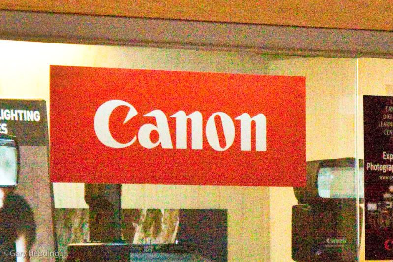

ISO 1600
IMAGE: http://img.photobucket.com/albums/v222/gheb88/IMG_9520-1.jpg

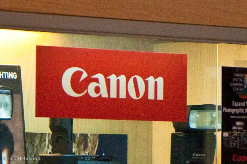

ISO 3200
IMAGE: http://img.photobucket.com/albums/v222/gheb88/IMG_9521.jpg

My conclusion is that the two are so close it's almost a non-issue. The 50D seems to exhibit a TINY bit more noise, but it is only apparent looking at 100% crops here. Quite frankly I'm impressed with the 50D ISO performance for having an extra 5mp on the same sized sensor. I wasn't expecting it to be SO close to the 40D. Also live view with the new screen is wonderful. Looks like I'm pretty sure I know what my next body will be ;)
