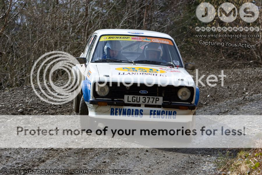

All exif should be in tact Shot at 1/640th @ f6.3 I would expect the shots to be like the first all crisp and sharp as they usually are well were!
Decent shot
IMAGE: http://i453.photobucket.com/albums/qq256/JMSPhotographic/JMS_BIR_900_01.jpg

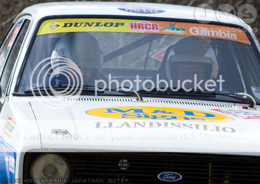

A crop of the above
IMAGE: http://i453.photobucket.com/albums/qq256/JMSPhotographic/JMS_BIR_900_02.jpg
Not as good as it should be but with some processing in photoshop it is good enough for a A3 print
Next shot in the frame, looks decent here
IMAGE: http://i453.photobucket.com/albums/qq256/JMSPhotographic/JMS_BIR_900_03.jpg

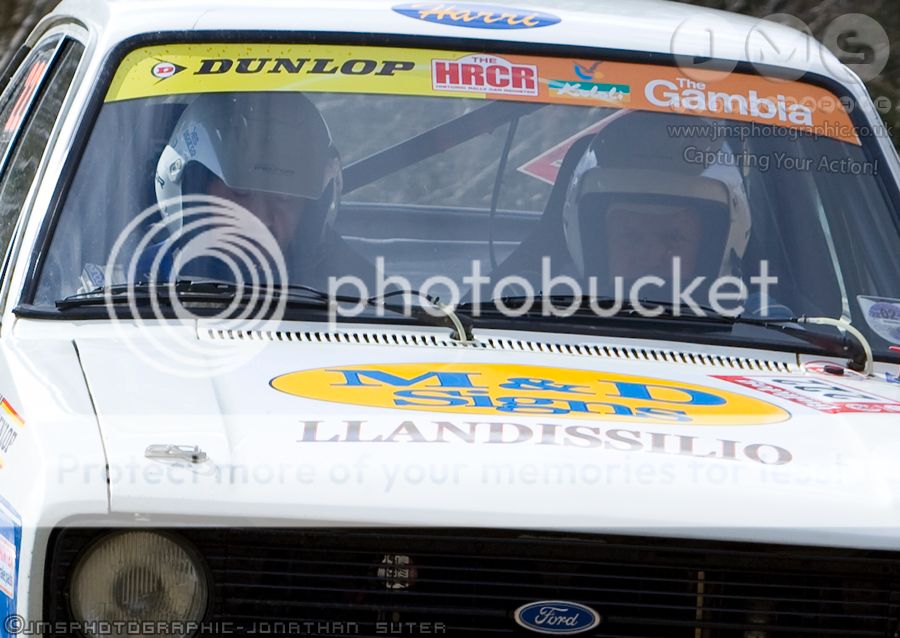

Not so good here, notice how much softer the top of the car has gone but the ford badge has stayed the same this is what it produces more than the above.. This gets binned in my eyes as it will never make a tidy A4 print without a silly amount of sharpening!
IMAGE: http://i453.photobucket.com/albums/qq256/JMSPhotographic/JMS_BIR_900_04.jpg

Where was the focus point in these frames? Assuming the centre point was used, I would say that these shots are exactly what you should expect. There are many different points of good contrast right near the centre of the frame, but the one smack in the middle is the hood --> grill transition. The Ford logo is sharp in both shots, which suggests that the camera was focusing on the grill, which it did perfectly.
The sharpness discrepancy is due to the car being in a different position relative to the DOF, but the camera (focused on the grill) doesn't know that. Hopefully that makes sense. I wouldn't go ditching the camera just yet. And as an aside, I would have no problems printing that second shot at A3 after a bit of sharpening. I doubt anyone aside from you would ever notice the "softness" if the first shot wasn't there to compare.
Also, I'm assuming you just upgraded to the 1DII from the 40D -- you have to understand that the 1DII has the strongest AA filter of any Canon DSLR, and is thus the softest straight out of camera. The recommended baseline sharpening (from Canon) is unsharp mask of 300% 0.4 radius. That first shot you posted is as sharp as things will ever get without sharpening.
