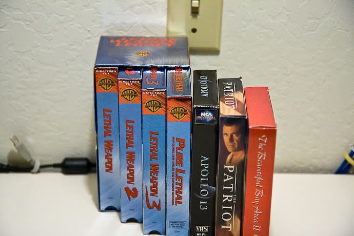

Are you focusing using only the center AF point are you letting the camera auto select the AF point?
Center AF point.

Your photo with Unsharp Mask sharpening...which would not fix focus issues.

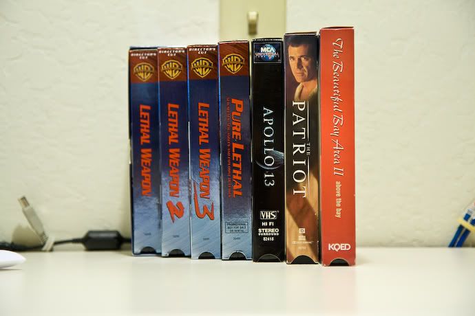

The right type of test setup, as recommended by Canon for microfocus...perpendic​ular surfaces.
IMAGE: http://i69.photobucket.com/albums/i63/wiltonw/Focustest-2.jpg
Sample shot using this setup.
http://i69.photobucket​.com …s/i63/wiltonw/i​mg9820.jpg (external link)
Here was my edit of the pic:

Not sure what the point of your last post was...I was merely trying to show the photo's owner (you) what some Unsharp would do to improve the sharpness of the car door handle, which was complained about. After seeing the photo I posted, are you still unhappy?

Not sure what the point of your edit was...I was merely trying to show the photo's owner what some Unsharp would do to improve the sharpness of the car door handle, which was complained about
The owner of the photo was me and I know what unsharp mask can do...and use it frequently. This however does not resolve my lenses focusing issue.

Yesterday I took the plunge and upgraded my XSi to a 50D. Today I dinked around with micro focus adjustments on my 17-55 and ended up giving it a -6 tweak. It looks to be noticeably better, but I haven't given it a proper field test yet. It was easy to play around with the micro focusing on the 50D. Nothing extravagant, just a drafting ruler at a 45% angle, camera on a tripod, set it to spot metering, took a shot and zoomed in all the way. I made some course adjustments first, +10, just to see what the change would be, and it was very obvious since it was front focusing (went the wrong direction) so I tried -10, which was better but a bit too much. After some fine tuning -6 looked the best. Hope this makes me feel better about all the money I spent on this lens. Jury is still out.
