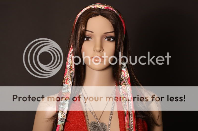

First the skyport alone at 1/200, all at F9:
IMAGE: http://i604.photobucket.com/albums/tt130/pnmd/skyport200.jpg

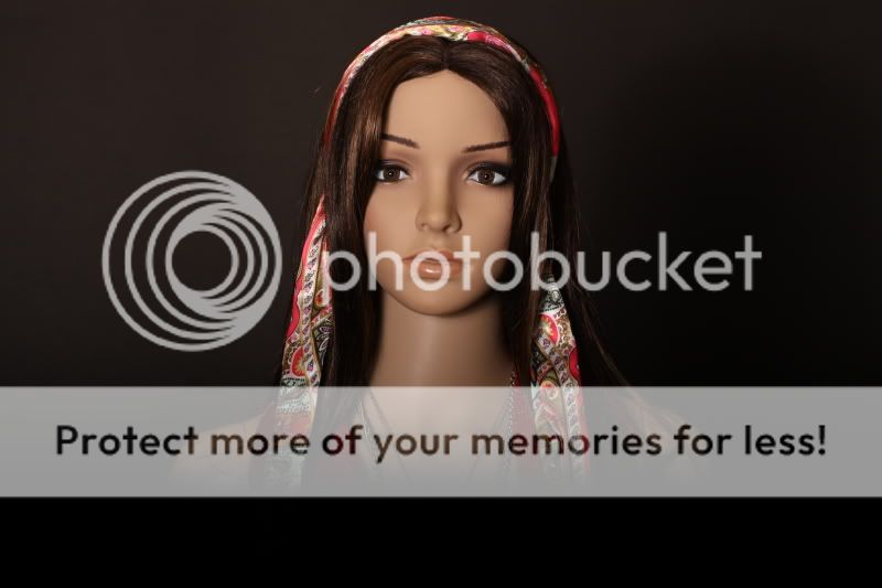

skyport at 1/250:
IMAGE: http://i604.photobucket.com/albums/tt130/pnmd/skyport250.jpg

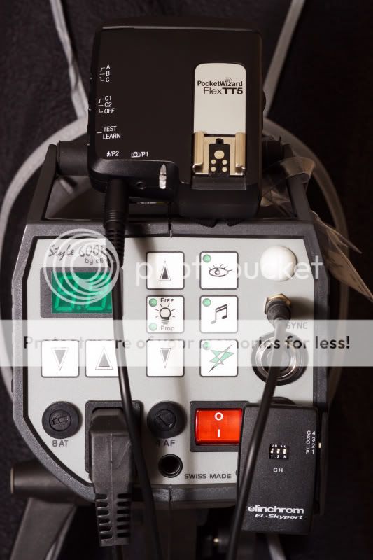

I have a Canon 50D and mounted a MiniTT1 on it then taped the flash mount and placed the Skyport on top of that. Using the Skyport to change the power on the RX600 worked flawlessly.
RX600 with FLexTT5 and Skyport:
IMAGE: http://i604.photobucket.com/albums/tt130/pnmd/IMG_7604.jpg

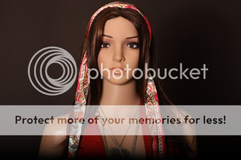

IMAGE: http://i604.photobucket.com/albums/tt130/pnmd/Flex250.jpg
Flex at 1/320:

The Skyport shows banding at 1/250. The Mini/Flex shows banding at 1/320 but still useable.
