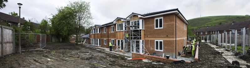

This is Recti-Perspective too from another user; the pano has a field of view of 155,7º! with not much distortion in the edges:
IMAGE: http://i21.photobucket.com/albums/b279/terrywoodenpic/sitepan-web.jpg
The program can easily be used to turn one single rectilinear image straight from your wide angle lens, into any other projection.
