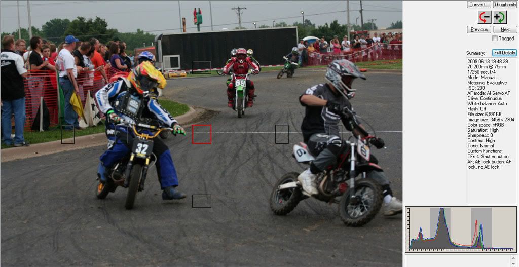

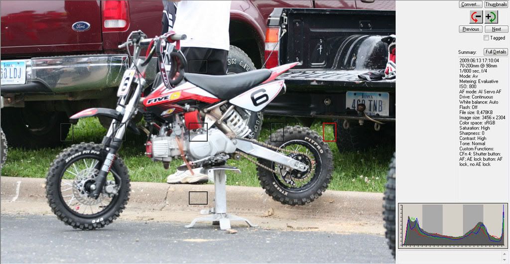

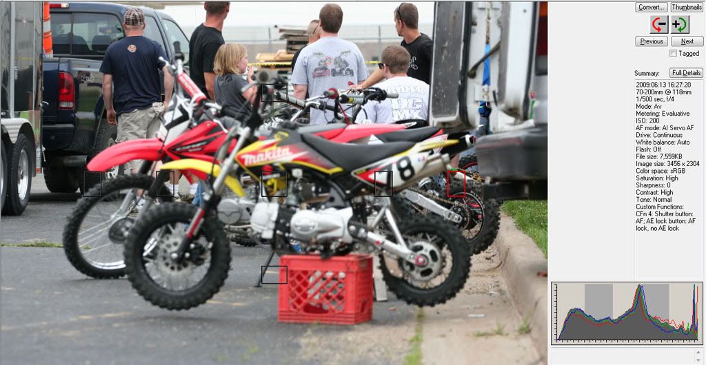

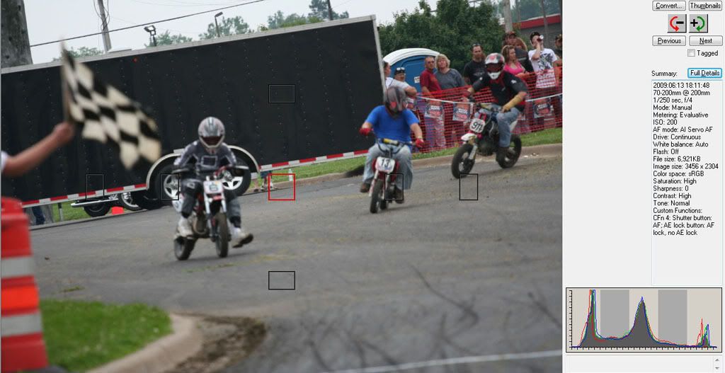

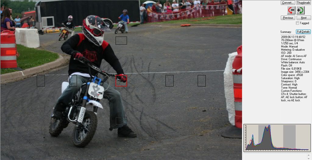

I bought a 70-200mm F4 off a member here a few months back and had my first chance to really use it. For the most part it kept wanting to focus behind the subject. I was using an XT and had it in AI Servo and focus points were set to all and the depth switch was set to 1.3m. Maybe its just me, but I have never had this much problem with focusing on a moving subject with other lens.
Examples:
1.

2.
IMAGE: http://i44.photobucket.com/albums/f39/sethmo38/Randoms/IMG_5786_FP-1.jpg
3.
IMAGE: http://i44.photobucket.com/albums/f39/sethmo38/Randoms/IMG_6002_FP-1.jpg
4. This seemed to be a common theme, the focus usually tended to be on the orange barrel on the left.
IMAGE: http://i44.photobucket.com/albums/f39/sethmo38/Randoms/IMG_6329_FP-1.jpg
5.
IMAGE: http://i44.photobucket.com/albums/f39/sethmo38/Randoms/IMG_6322_FP.jpg

From looking at the photos you attached, it looks like you missed focus (i.e., focused somewhere other than where you intended) in almost every one of them. There are points in each frame that are in focus - they're just not the ones you wanted. Try manually selecting a focus point instead of using all points - the outcome with all points is too unpredictable.

Take a look back at your photos and see where the active (red) focus point is in each one. In #1 it's on the tire of about the third bike back; in #2 it's on the grass and the truck's left rear tire; in #3 it's on the curb behind the trailer; in #4, on the rider's hand and the asphalt behind him; #5 it's on the asphalt right at the white line, behind the rider.
That's the disadvantage to letting the camera choose the focus point. It really has no idea what you're actually trying to focus on and is just going to make it's best guess - which often isn't what you wanted at all. The rest of your settings look fine as far as I can see (except that you really didn't need AI Servo for the static shots of the parked bikes). I've never shot an XT, but if it allows you to manually select your focus points I'd try that - if you choose the point and put it on what you're trying to focus on, it's pretty much guaranteed you'll get the results you want.
