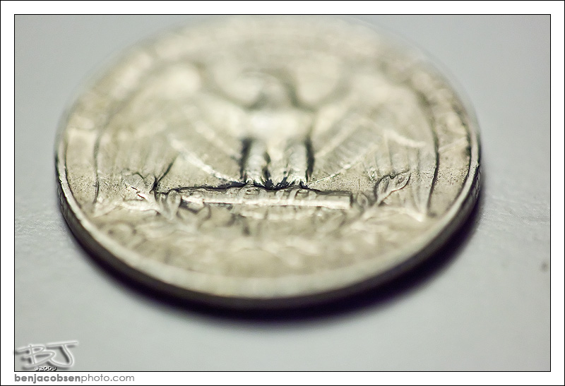

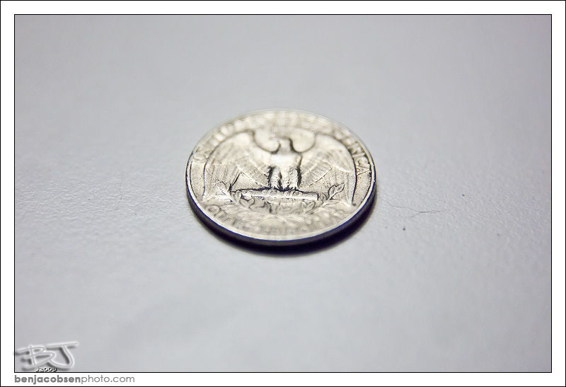

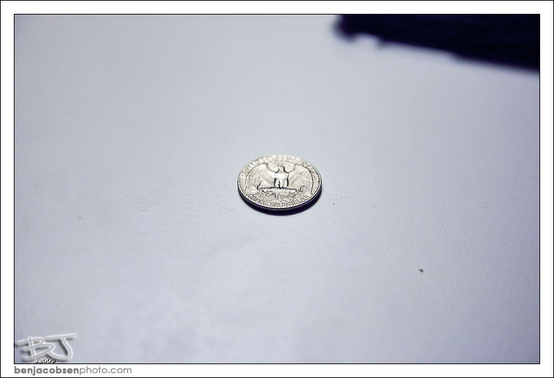

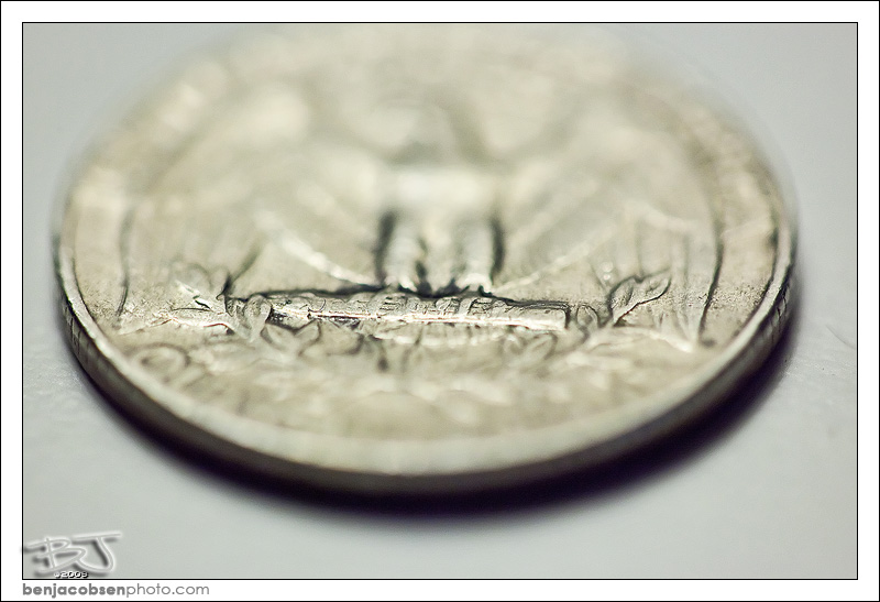

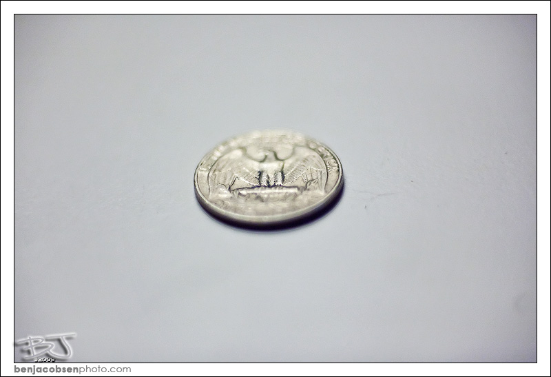

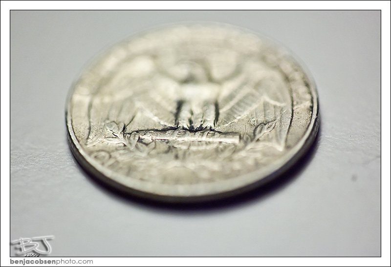

I recently took a 100mm macro in on trade for my sigma 20mm... It's a lens I owned ages ago, but rarely used. I've often wondered how it'd do against the tubes I have now, so I figured it'd be worth the trade to most likely sell later.

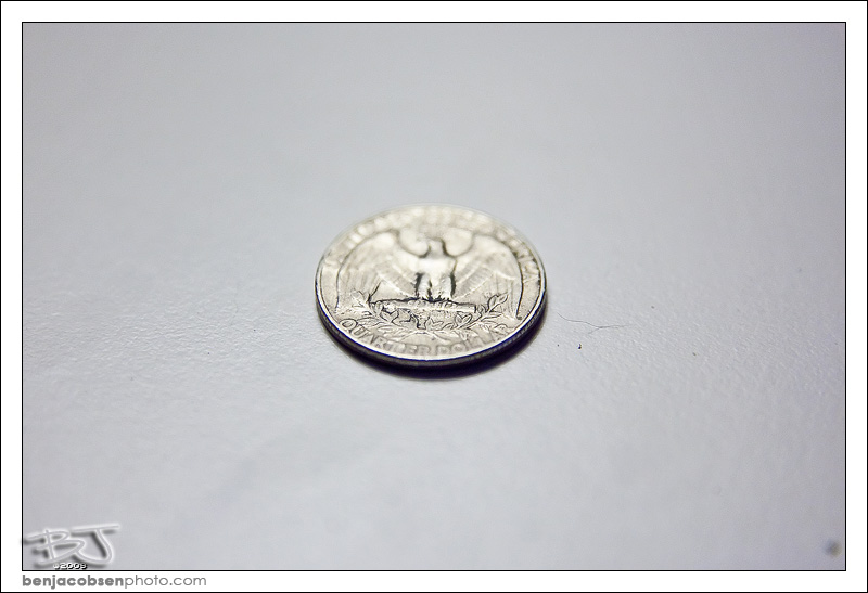

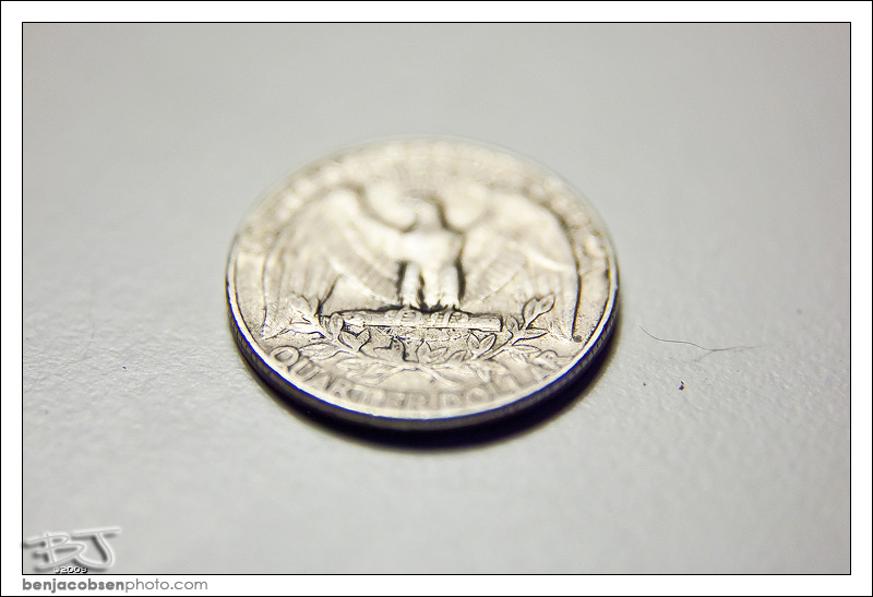

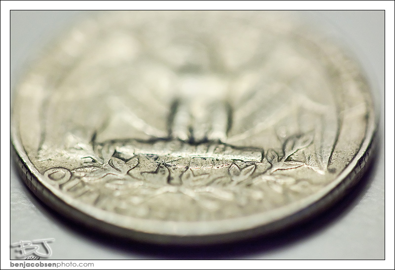

Here's what the 100mm macro can do -vs- tubes. All shots are at MFD for the lens. The 24-105 is zoomed all the way in (in a few cases it's at 102 0r 103, but exifs are intact). All lenses are wide open and all at manually focused to MFD then MOVED so the branch was roughly in focus.
24-105, no tubes:
IMAGE: http://gear.benjacobsenphoto.com/wp-content/gallery/canon-100mm-macro/img_9437.jpg
24-105, 12mm tube:
IMAGE: http://gear.benjacobsenphoto.com/wp-content/gallery/canon-100mm-macro/img_9436.jpg
135L, 12mm + 20mm = 32mm tubes:
IMAGE: http://gear.benjacobsenphoto.com/wp-content/gallery/canon-100mm-macro/img_9438.jpg
24-105mm, 20mm tube:
IMAGE: http://gear.benjacobsenphoto.com/wp-content/gallery/canon-100mm-macro/img_9435.jpg
24-105mm, 12mm + 20mm = 32mm tubes:
IMAGE: http://gear.benjacobsenphoto.com/wp-content/gallery/canon-100mm-macro/img_9433.jpg
100mm macro, no tubes:
IMAGE: http://gear.benjacobsenphoto.com/wp-content/gallery/canon-100mm-macro/img_9439.jpg
100mm macro w/12mm tube:
IMAGE: http://gear.benjacobsenphoto.com/wp-content/gallery/canon-100mm-macro/img_9440.jpg
100mm macro w/20mm tube:
IMAGE: http://gear.benjacobsenphoto.com/wp-content/gallery/canon-100mm-macro/img_9441.jpg

100mm macro w/12+20=32mm tubes:
IMAGE: http://gear.benjacobsenphoto.com/wp-content/gallery/canon-100mm-macro/img_9442.jpg
also, I do have a third tube that came in the set. I had loaned it to someone at work and didn't have it when I did this test. I can't see using the 100mm macro with tubes much, so personally I just want to get in to that level with tubes and the 24-105... The 24-105 is getting close with the 2 tubes combined. The third tube is 36mm on it's own, which would give slightly more magnification than shown above, but with it and the other tubes you can also have 48mm, 56mm, and 68mm...

He used all the tubes he had on the 135mm L, you can see it was not very close, and thus only the one shot. IMHO the 135mm L is a great prime.

but to clarify, the 135L portion of this test was shot with the 12 and 20 tubes. But the 36mm tube wasn't here so I couldn't test it. I'll restack all three when I get a chance, but I know my 24-105 will be closer anyway so it's kinda a moot point now.
