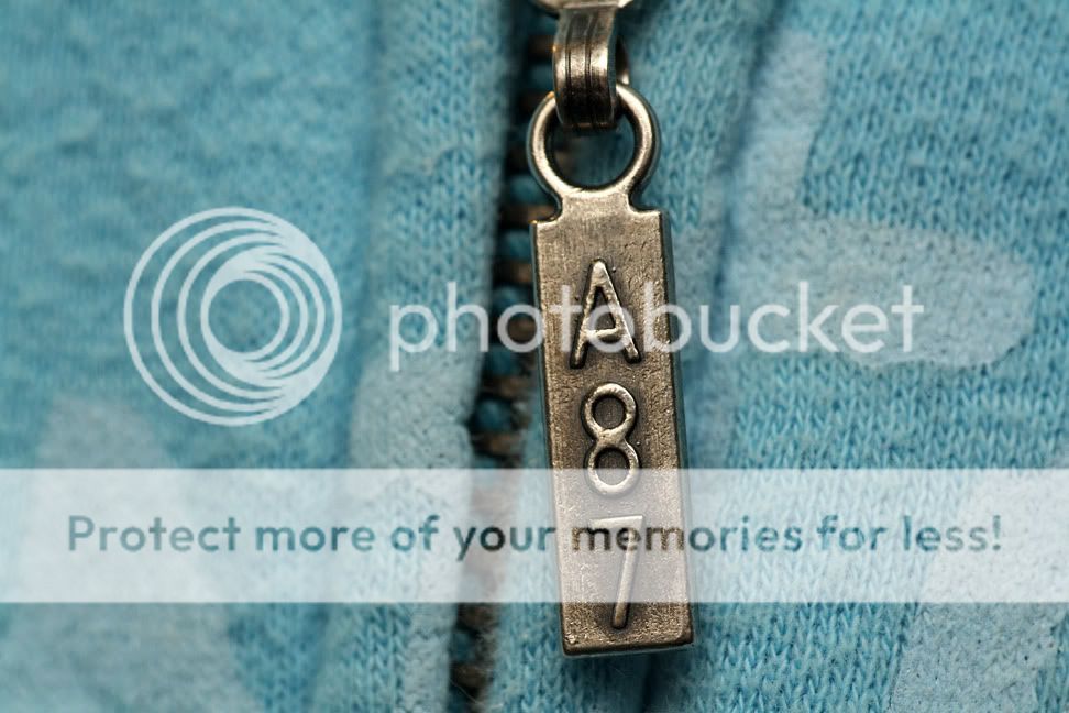

Actually I got my Autofocus macro lens for the price of a set of Autofocus extension tubes.
IMAGE: http://i416.photobucket.com/albums/pp241/tkbslc/lens%20samples/100mmmacro1.jpg
IMAGE: http://i416.photobucket.com/albums/pp241/tkbslc/lens%20samples/100mmmacro2.jpg
IMAGE: http://i416.photobucket.com/albums/pp241/tkbslc/lens%20samples/IMG_7898.jpg

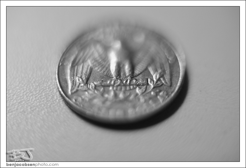

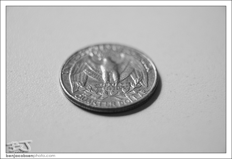

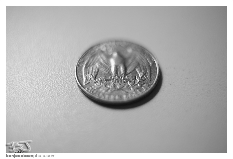

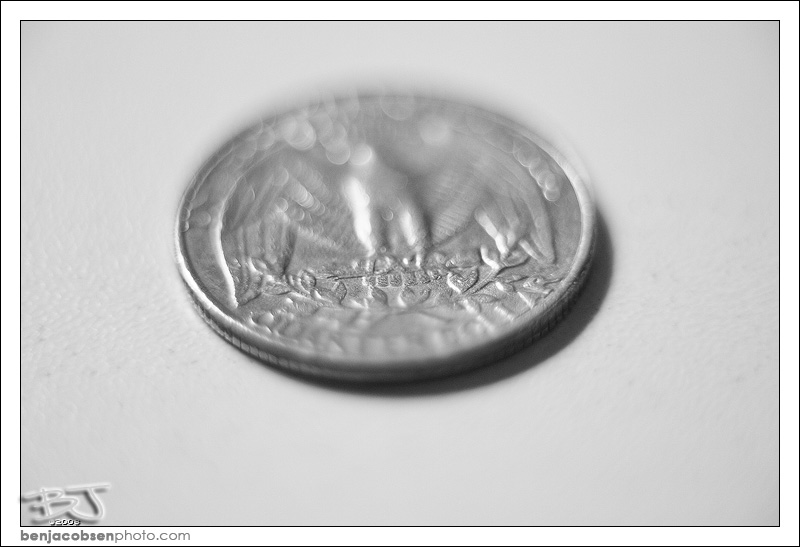

some more tests:
105mm w/ all 3 tubes:
IMAGE: http://gear.benjacobsenphoto.com/wp-content/gallery/canon-100mm-macro/img_1220.jpg
35mm with 12mm of tubes:
IMAGE: http://gear.benjacobsenphoto.com/wp-content/gallery/canon-100mm-macro/img_1221.jpg
50mm w/ 12mm of tubes:
IMAGE: http://gear.benjacobsenphoto.com/wp-content/gallery/canon-100mm-macro/img_1222.jpg
100mm with all 3 tubes:
IMAGE: http://gear.benjacobsenphoto.com/wp-content/gallery/canon-100mm-macro/img_1223.jpg
also, the 24-105 with all three tubes, set to MFD and 105mm would basically focus down to the front element (I was within an inch and couldn't get it to focus on my fingertip)!!! But it needed to be further away to get light on the damned quarter!
