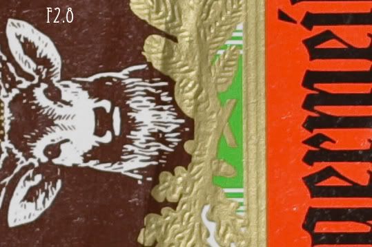

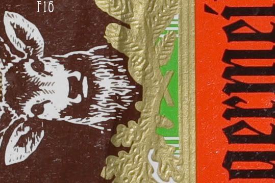

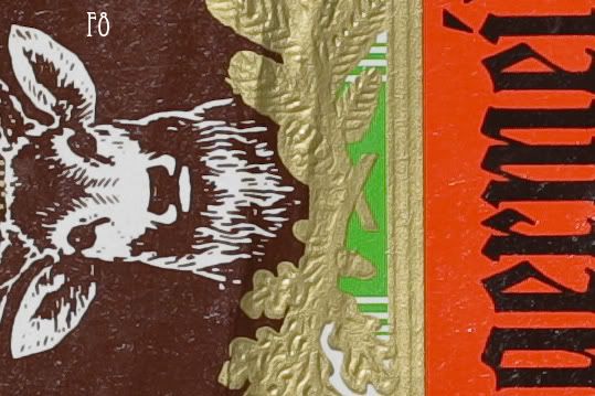

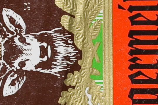

Shot on a tripod, MLU and 2 second timer. Lighting is a single White Lightning strobe. These are very small 100% center crops from full size files. Shot RAW and ran thru lightroom with a slight contrast, about 10 clarity and a very mild sharpen. Lens is a 50mm f1.8 mkI
What do the results tell me? Diffraction exists and is slightly noticeable at f16, and more of an issue at f22.... but still very usable.

Looks sharpest at f5.6. Thanks for the test.

I'd say looking at these photos I should be more concerned about softness at wide open than diffraction at F22. Admittedly I don't really know what it is I'm trying to see when judging diffraction anyway, but to me 2.8 seems a lot softer than F22 here.
What exactly am I supposed to be looking for when checking for diffraction in any of my photos??

F/5.6 is excellent, but your test shows that diffraction is not to be feared as many claim.

I never worry about diffraction - I mostly shoot landscapes and small apertures are a must - while there is no doubt that f16 does not deliver the sharpest picture, the results are more than satifactory and certainly look better than having just part of your subject in focus.

Very interesting. Clearly diffraction is less of a problem than lens softness wide open.

The slight sharpening during conversion has "reversed/hidden" some of the softening that occurred. The softening happens to all pixels and the sharpening too - you are not seeing all the diffraction "loss" but have also seen how it can be reversed up to a point. All you need to do now is print that composite image at a range of sizes and view the prints as you would normally. You'll see that the range of apertures that look sharp in the prints may be broader than at 100% pixel peeping. You will then be in a position to make your own, real-life tested judgement on when to "worry" about diffraction. So, for example, if you are taking a shot that you know won't be printed large, you can stop way down to 22 (or even further, maybe) but if you know you might want to print a large print of a landscape/sunset/Schna​pps bottle/whatever, you'll know how far you can stop down before seeing an undesirable level of the effect. Who needs theory, when you have your own data for your own workflow?!

Certainly not true, if you compare the F2.8 and the F4 you see such a great difference that its worth to shoot it at F4, F5.6 is sharpest imho.
